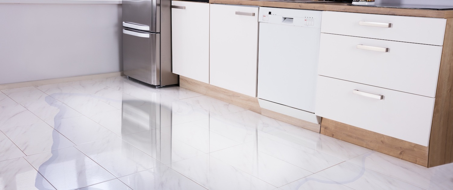

Is your dishwasher turning your kitchen floor into a mini pool? Don’t let a leak disrupt your routine or lead to costly repairs. Dive into our step-by-step video guide just below to uncover the six common culprits behind a leaking dishwasher and learn how to fix them — keeping your home dry and your wallet happy!
A leaking dishwasher can create a puddle on your floor and stop your ability to do your dishes. There are six main components that can contribute to a leaking dishwasher. Follow this easy guide to diagnose what needs to be fixed on the dishwasher and save money doing it yourself.
