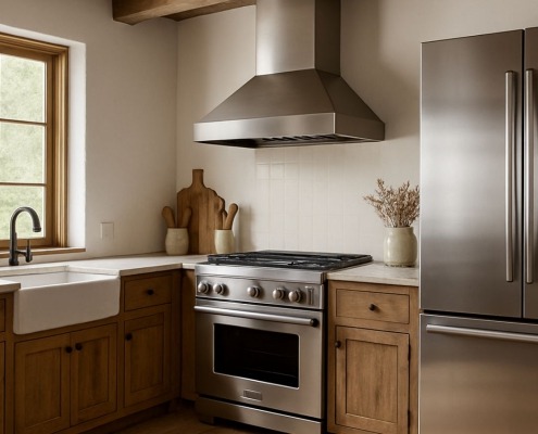

Installing a gas stove can feel a little intimidating, but with the right knowledge, tools, and safety steps, a gas stove installation can be a perfectly manageable DIY project.
We’ll walk you through easy steps for a safe and successful gas stove installation, covering everything you need to know. Whether you’re replacing an old model or upgrading your kitchen setup, this is your go-to resource for doing it the right way.
