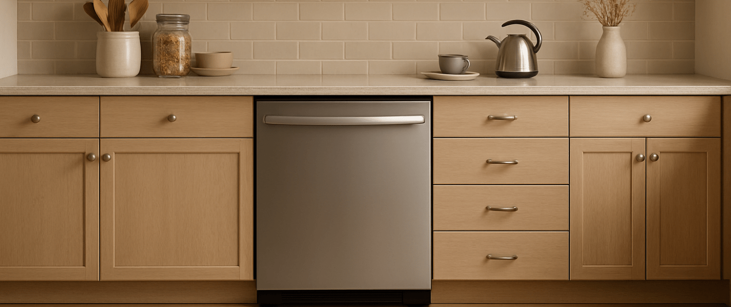

Is your Frigidaire dishwasher looking a bit worse for wear with a cracked or missing toe panel? Don’t worry—this common issue is easier to fix than you might think! With just a screwdriver and a few simple steps, our handy how-to video below will guide you through replacing that kickplate and restoring the sleek, polished appearance at your dishwasher’s base. See how easy it is to give your kitchen a quick makeover!
Looking for the right part? Enter your appliance model number below to find the exact match and get your appliance running like new again!
If the toe panel under your Frigidaire dishwasher is cracked, missing, or just missing up, it’s time for a fresh kickplate. The part you’ll need is 154589503, and replacing it is one of the easiest repairs you can do, no need to mess with water lines or wiring. Just grab a screwdriver and follow this quick guide to restore that clean, finished look at the base of your dishwasher.
