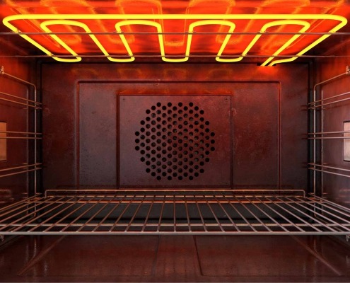

1. Oven Ignitor
If the ignitor on the stove goes bad, it will cause the gas to flow out of the range, but it may not be able to create the spark to light the flame. Igniters are fickle and often need replaced over time, which can lead them to be unable to light. If the ignition source cannot light the gas, it will continue to flow from the appliance and out into the room, which can become dangerous if left unattended.
Make sure that your pilot light is lit and that the range fires appropriately, even if you’re just preheating the oven, before you leave the unit unattended. Replacing the igniter or other components is not difficult, but it should be done by a licensed and trained professional.

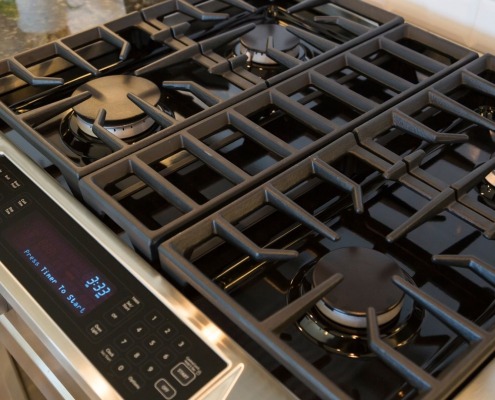

2. Burner Tubes
The burner tubes in the gas range are designed to transport the gas between the gas supply and the cooktop burners. These tubes could be clogged with buildup or debris, causing the gas supply to be blocked so that it is still flowing but not igniting. This buildup of gas will create a gas smell. These usually have a compression fitting on them, but not always. You will typically have to remove everything and lift the cooktop to access these tubes.
These tubes can develop cracks or other damage over time. Be sure to inspect them carefully for physical damage. You should also use a leak detecting fluid to check the burner tubes for leaks. If you notice any leaks, the tubes will need to be replaced.
3. Cooktop Burner Valves
The burner valves are what you turn to send gas into the burner head. They usually consist of a mounting block and a valve, as well as a connecting point for the burner tube. They’re usually located right behind the control panel. Some models will allow you to see the shaft when you remove the knobs, but you’ll have to lift the cooktop to get full access. If these knobs start to go bad, you could get a gas smell because the valve isn’t opening properly when you turn the knob.
Make sure the two screws behind the switch are tight and coat the valves with the leak detector. Turn the gas on temporarily and make sure that there are no bubbles. If you see bubbles, it means that the valves are leaking and will need replaced.
