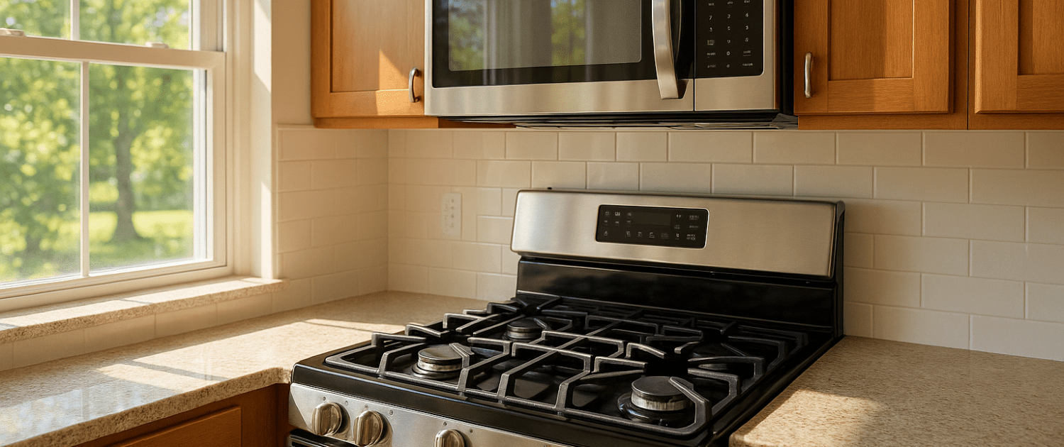

GE Gas Range Orifice Spud WB28K10023 Replacement
Steven E / Monday May 19, 2025
Tired of your GE range burners acting up with low flames or stubborn ignitions? You’re in the right place! Discover how replacing a simple yet crucial component—the orifice spud—can restore your burners to peak performance with our easy DIY guide, complete with a how-to video just below.
Looking for the right part? Enter your appliance model number below to find the exact match and get your appliance running like new again!
Replacing the range orifice spud in your GE range is a straightforward do-it-yourself project that you can knock out in under an hour with just a few tools and a little know-how. This part regulates the gas flow to your range burners and over time it can get clogged or damaged, causing burner issues.
