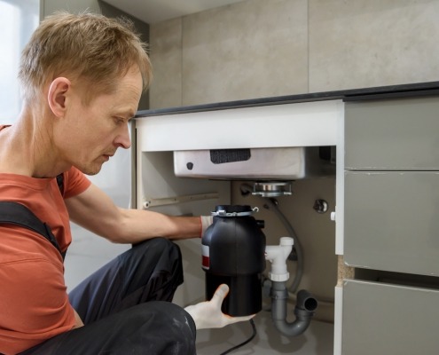

- Lift the disposal into position beneath the sink and secure it. Make sure it’s properly seated, and that the three locking tabs on the disposal’s mounting ring line up and engage with the sink-side mounting ring.
- Once aligned, turn the mounting ring counterclockwise by hand to start it, then use the special tool that came with your disposal – it looks a bit like an allen wrench – to tighten it all the way. All three tabs need to lock over the ridges for it to be secure.
- Rotate the disposal itself to line up the plumbing hookups. It should turn by hand if it was installed properly.
- Check your discharge tube. At this point, you may need to trim the tube down or buy additional tubing so that it will all fit.
- Connect your tubing. Connect your discharge tube to the straight pipe and, if you have it, connect the dishwasher tube to the fitting where the knockout plug was. Be sure to clamp down the dishwasher tubing. A 5/16-inch nut driver will be necessary to tighten that down.
