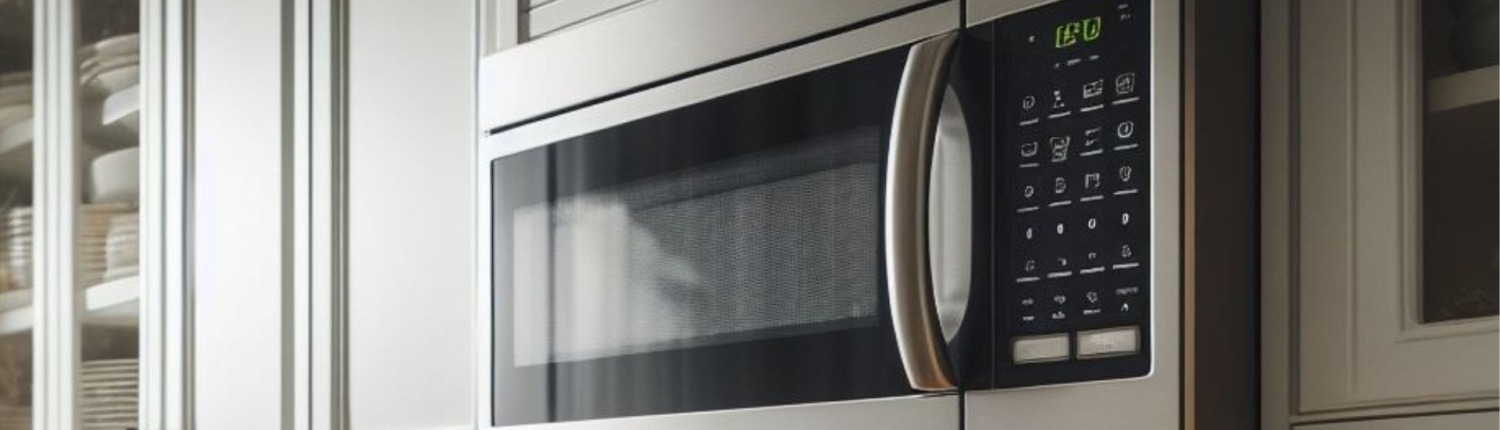

Ever found yourself in a dimly lit kitchen while attempting to use your over-the-range LG microwave? A burned-out light bulb can leave you in the dark, quite literally. Fear not! With our easy-to-follow guide and a handy how-to video just below, you’ll have your microwave shining bright again in no time.

Most over-the-range LG microwaves have two light bulbs – one located behind the vent assembly (upper light bulb) and another mounted on the bottom (lower light bulb). Here’s how to replace them in case either one goes dark.
