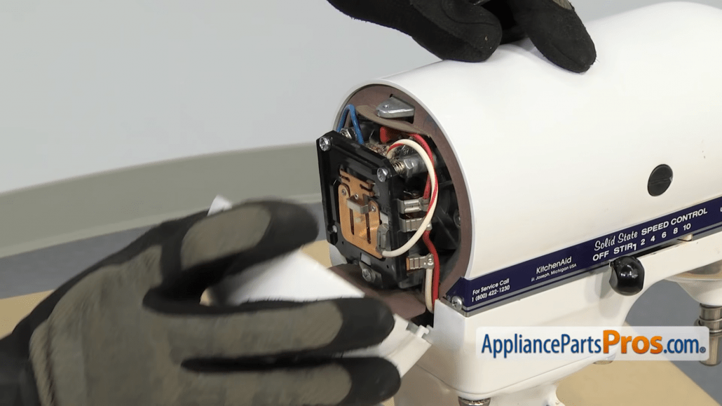

Start by removing the back cover on the head of the mixer. This is held in place by a single Phillips head screw. With the screw out, rotate the cover down and then lift it out of place. Be careful not to pull it too hard if it resists, as it’s held in place by a couple of plastic mounting legs that can snap if mishandled.
Gloved hands removing the back cover on the head of the Kitchenaid stand mixer
With the cover off, the next part to remove is the decorative metal strip around the mixer head. To do this, remove the two Phillips screws on either side of the back of the mixer that are pinning the strip down. It should then come away by hand.
Gloved hands remove the decorative trim on a KitchenAid mixer

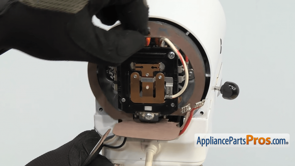

Step Two: Remove the motor housing seal
At the back opening, surrounding the speed control plate, there should be a cardboard ring. This ring acts like a seal, muffling noise while the mixer is running. It will need to be removed to replace the speed control board.
Gloved hands removing the cardboard ring inside the KitchenAid stand mixer.

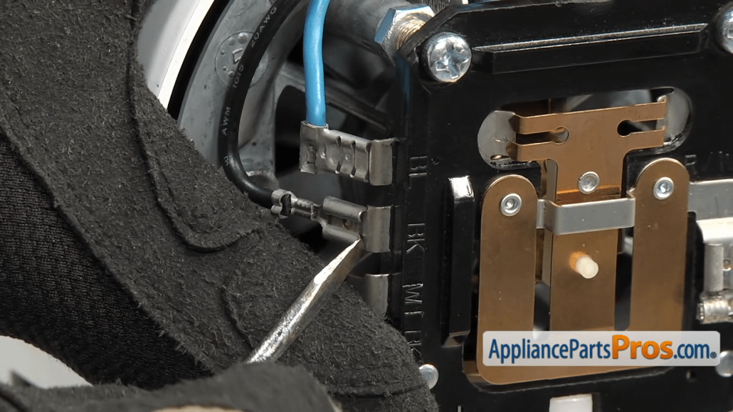

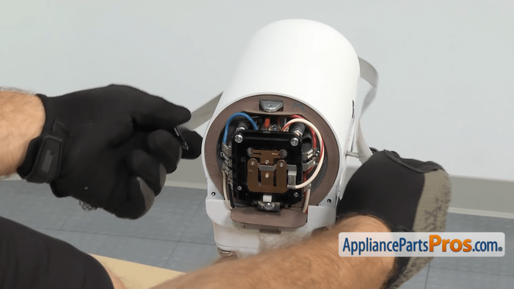

First, check your speed control board. It should be labeled to indicate which wire goes where based on its color. If it isn’t, take a picture now so that you have it as a reference when reassembling everything.
Next, disconnect the grounding wire and the bottom two wires on either side of the board. You can do this by popping most of them off with a flathead screwdriver. A Phillips screwdriver will be needed to disconnect the grounding wire. Once all wires are disconnected, carefully move them out of the way.
Gloved hands disconnecting wires inside the KitchenAid stand mixer.
With the wires out of the way, the motor housing seal can be removed and set aside. If it is damaged or missing, now would be a good time to replace it with a new motor housing seal. You can also check out our video guide to replacing a motor housing seal on our YouTube channel!

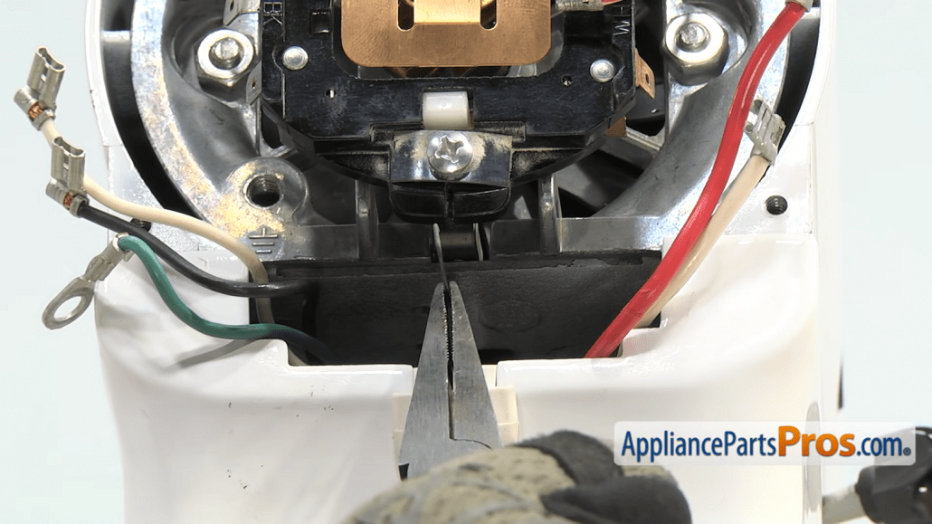

Step Three: Remove the retaining spring from the speed control plate

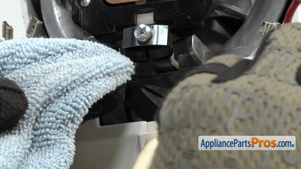

Have your towel and needle-nose pliers ready for this step! At the bottom of the speed control plate is a spring which you will need to remove with a pair of needle-nose pliers.
Do not let this spring slip away into the machine! You’ll have to disassemble much more of the mixer if this happens. To keep it from getting away, use your rag or towel as an anchor. Hook the spring into the towel, and let the towel hold the spring.
Gloved hands use a pair of pliers inside the KitchenAid mixer
Step Four: Removing the remaining speed control board wires
There should be four more wires still connected to your speed control board at this point, assuming you haven’t disconnected them already. You can go ahead and remove those now. Again, to make this process easier, pop each wire off with a flathead screwdriver or pair of needle-nose pliers.

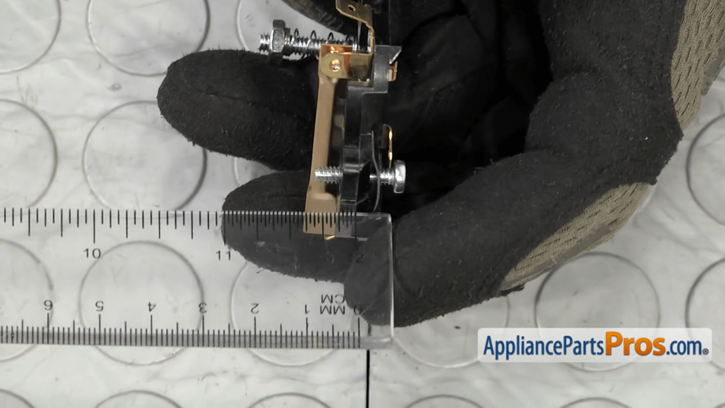

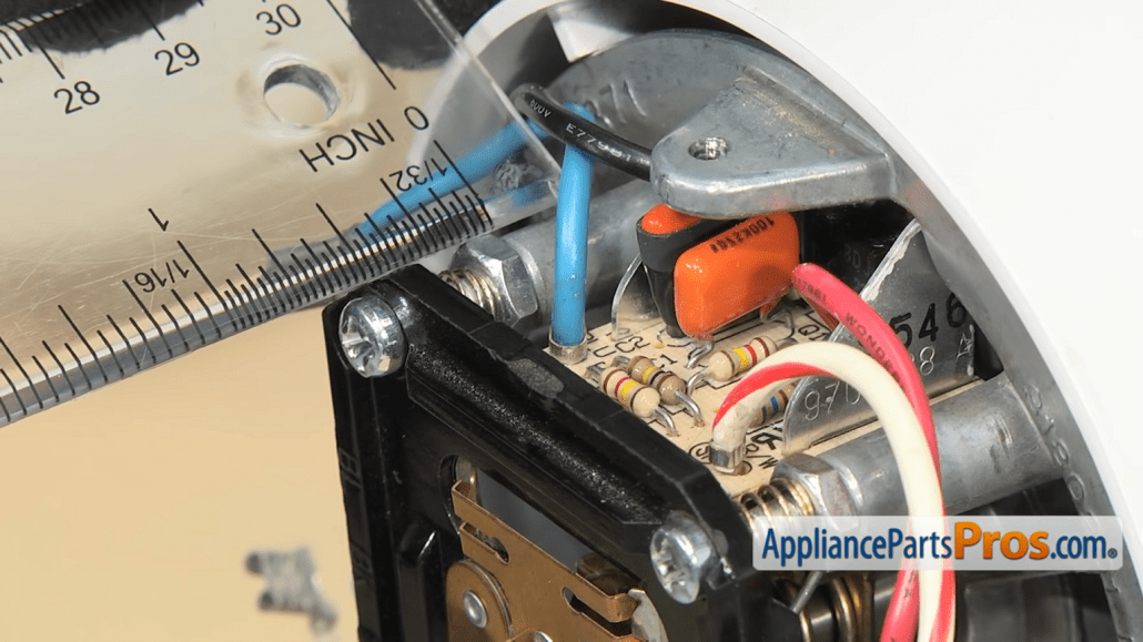

Step Five: Measure the distance of the upper two screws
The speed control board is held in place by a few spring-loaded speed control bolts. These bolts should be adjusted to a specific length. Consult your appliance’s manual for the default length (ours was ¾-inch), but you should also measure these bolts yourself, and write that number down.
To do this, use your ruler to measure the distance between the end of the mounting post for the screw to the back of the speed plate. When you install the new plate, you’ll want to make sure it is installed with the bolts at the same length.
Gloved hands use a ruler to measure inside the KitchenAid mixer

Step Seven: Prep the new speed control plate
You may need to do a bit of prep work for your new speed control board. Take care of the following, if necessary:
  • First of all, on the old board, measure the distance the bottom screw juts out from the plastic plate. Write this number down. On ours, the distance was 9/32-inch.
  • Next, check the bottom screw on your new speed control board. Does it have a metal spring lock mechanism creating space between the board and the screw itself? If not, you’ll need to remove the spring lock mechanism from the old board and install it on the new board.
  • Adjust the lower screw on the new control plate until it is the same length as the lower screw was on the old speed control plate.
Gloved hands measure the distance the bottom screw juts out from the plastic plate on a KitchenAid mixer

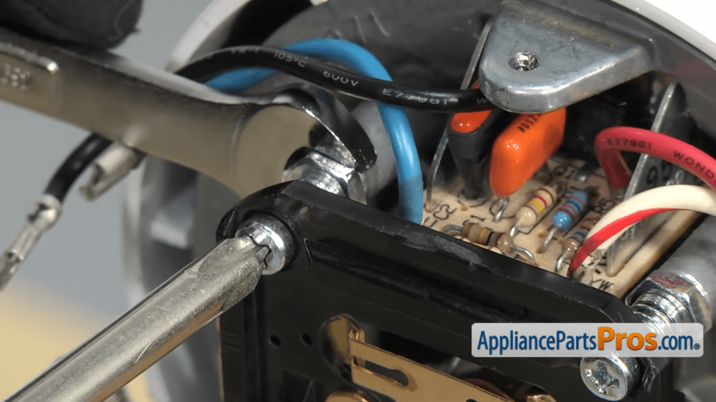

Step Eight: Mount the new speed control board on the mixer
Seat the new speed control board onto the back of the mixer. The white adjuster lever on the back of the mixture should fit onto an opening in the center of the speed control board.
Once it’s seated, tighten down the two upper bolts. Don’t screw them in all the way – shoot for roughly the same distance as the bolts were on the old speed control board. They don’t have to be perfect right away. When the board is secure enough that you don’t need to hold it in place, you can use your ruler to adjust the bolts to the proper length.
To secure these bolts, use your 11/31-inch wrench to snug the locking nuts down. You may need to keep the bolts from spinning while you do this. Steady each one with a Phillips screwdriver. Once the nuts are secure, be sure to double-check the length with your ruler.
Gloved hands using a Phillips screwdriver and a wrench inside a KitchenAid mixer

Step Ten: Reattach the bottom retaining spring to the plate
Retrieve the spring by carefully lifting the towel out of the mixer and grabbing the spring hook with the needle-nose pliers as soon as you are able. You can then set the towel aside and seat the spring on the bottom of the new speed control plate. Make sure it’s properly seated on the groove just below the lower screw.
Gloved hands holding a towel inside a KitchenAid mixer

Step Fourteen: Reinstall the back cover
Seat the back cover from the bottom, making sure the motor compartment seal and all wires are in place, and then rotate it up. Finish up the job by installing the Phillips screw at the top of the mixer’s back cover. You’re all done!
