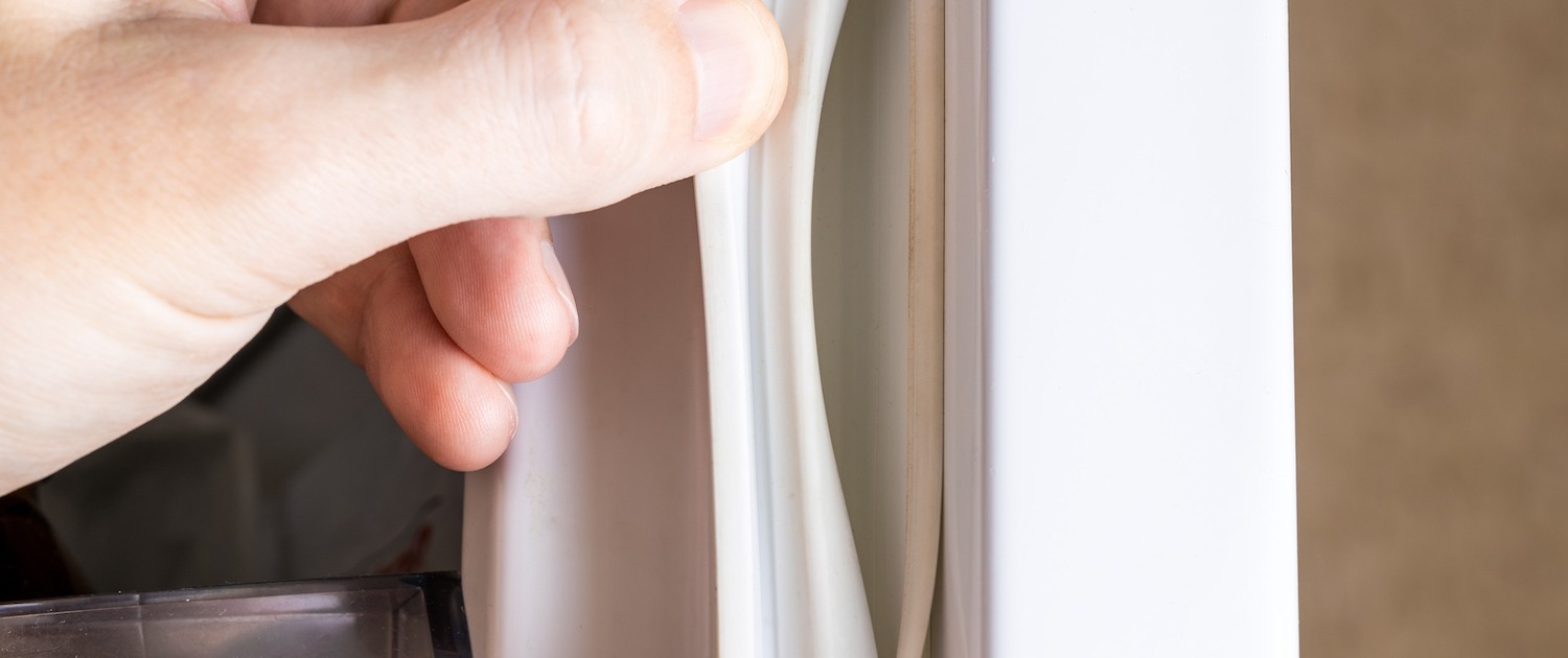

Signs That You Should Replace Your Refrigerator Door Gasket
Sometimes, a visual inspection of the gasket is enough to verify that it needs to be replaced, but there are a few other symptoms of a deteriorating door gasket:
- Tears or cracks may not be visible, so run your hands over the gasket to see if you can feel any damage.
- The door won’t stay closed, or there is no resistance when opening it.
- The refrigerator’s interior is warmer than it should be, or the air just around the door seam feels unusually cool.
- Condensation or “sweating” is forming on food at the front of the fridge or on the door itself. This condensation can show up on the interior or exterior.
- The fridge seems to be running constantly. If the gasket isn’t creating a proper seal, the refrigerator will run more to compensate for the loss of cold air.
