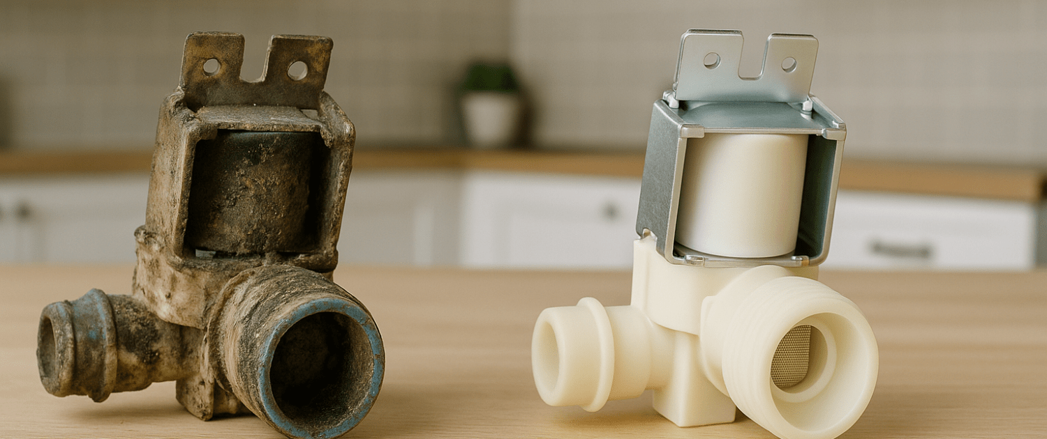

Is your Samsung washer not filling with water or taking forever to start a cycle? The problem might be a faulty water inlet valve, part #DC62-00214M. This valve controls the flow of hot and cold water into your machine and when it fails, your washer can’t do its job. The good news? Swapping it out is a fast and easy repair you can do yourself with a few basic tools. Let’s walk through what to expect and how to fix it.

The water inlet valve is typically located at the back of the washing machine. It has a solenoid that operates when the washer control board sends the signal. When activated, the solenoid opens the valve to allow cold water to flow into the various dispensers and tub. If the inlet valve is clogged or the solenoid is worn out, problems will occur.
