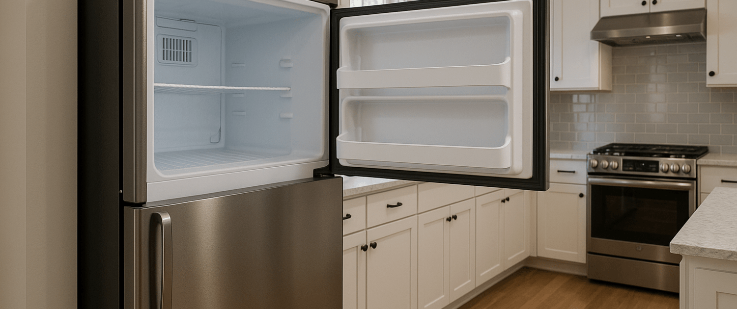

  1. Begin by opening the freezer door. Remove any food items to have access to the rear panel area.
  2. Take out the shelf inside the freezer compartment by pushing it back, lifting it up, and pulling it out.
  3. Use a quarter-inch nut driver to remove the two screws that hold the rear access panel in place.
  4. Once the screws are removed, pull up the bottom of the access panel, then pull down on the panel to remove it.
