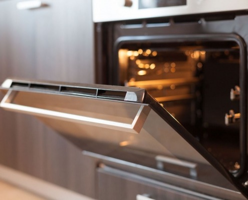

1. The Oven Door Gasket
That seal around your oven door is a vital component that keeps hot air in while you’re baking, roasting, and broiling things. This component can be found in one of two places: mounted on the door itself or on the inside of the oven opening, on the body of the appliance. Depending on which type of oven you have – standard or self-cleaning – you may have a rubber gasket or high temperature resistant fiber gasket installed. With age, the door gasket on any appliance will start to deteriorate. All that opening and shutting wears them out. Oven door gaskets, in particular, also have high heat exposure to contend with. If your oven door’s gasket is damaged, it could be preventing the door from closing and sealing properly.
It just takes a minute or so to inspect the gasket, and you don’t need any special tools to do it:
  • Start with a visual inspection of the gasket itself.
  • Even if you don’t notice any signs of damage, you should still run your hand over the gasket. Check for bunching, fraying, tears, or other issues that you might not have been able to see.
  • If you find that the gasket is damaged, whether or not it’s the cause of your oven door woes, you should replace it as it can affect your oven’s efficiency.
