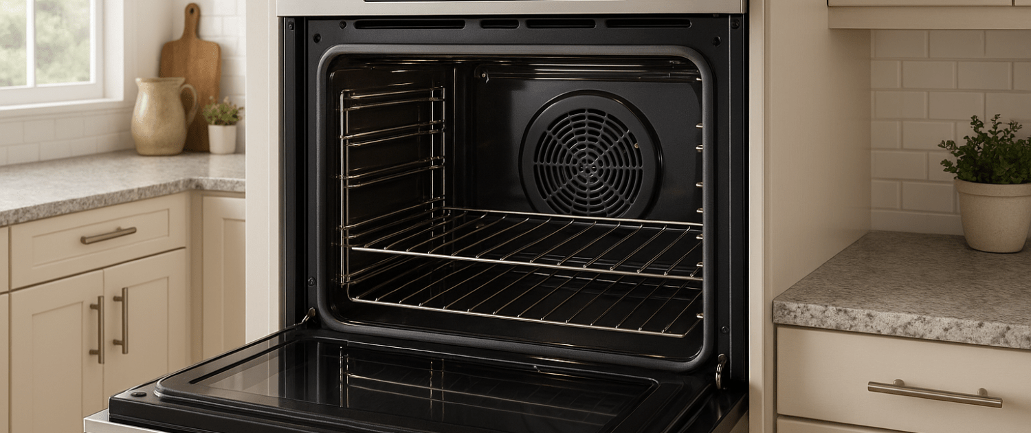

Most gas ovens have a fan and a thermostat to control the fan. The fan’s main job is to spread the hot air around so the oven cooks evenly.
When the oven gets really hot inside, the thermostat sends a signal to the fan, kind of like an electric message. This tells the fan to start blowing the hot air around. As the oven cools down, the thermostat sends another message to the fan to stop.
