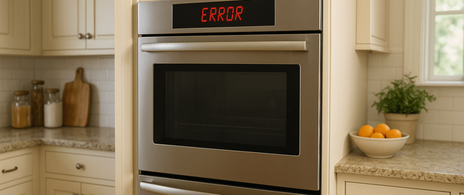

Seeing an F111 or F113 error code appear on your Bosch oven? These fault codes indicate a runaway oven temperature, meaning the internal cavity has exceeded safe thresholds during cooking or self-cleaning. Left unchecked, runaway oven temps can pose a serious fire hazard. This is why Bosch ovens alert you with F111 or F113 errors triggering automatic shutdown. In this guide, we’ll explain the causes of F111 and F113 Bosch oven error codes and walk through steps to troubleshoot each one.

The F111 error code indicates the oven cavity has surpassed 585°F when not expected. This typically only occurs during normal cooking modes.
Whereas the F113 code means the oven interior has exceeded 950°F, which is most common during self-cleaning operation.
Once the control board senses these excessive runaway temperatures via the sensor, it immediately shuts off power and displays the error.
