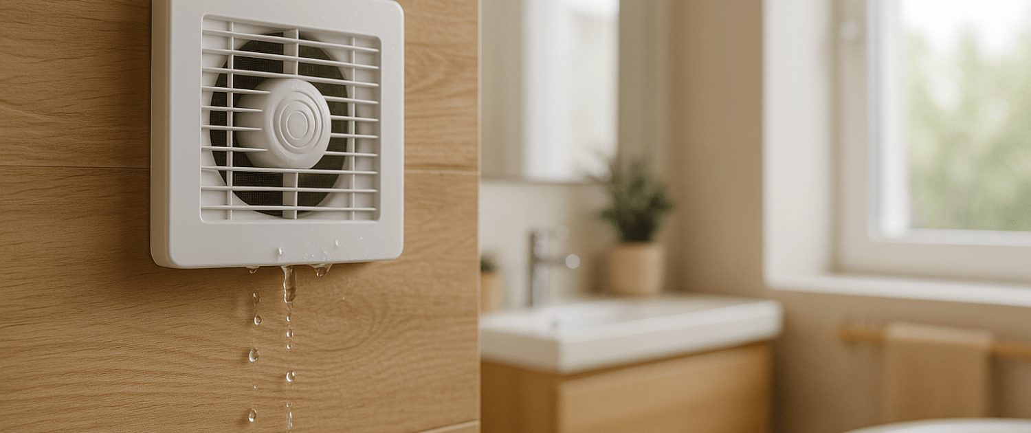

1. Condensation in the Ductwork
The most common reason a bathroom fan leaks water is condensation. As warm, moist air from the bathroom moves through the fan and into the cold ductwork, especially in attics during winter, it cools down. Moisture condenses on the inside walls of the duct and drips back toward the fan.
What it looks like:
- Water drips from the fan grille, especially after showers
- A damp ceiling around the fan
- Drips increase during cold weather
Why it happens:
- Poor duct insulation in cold attic spaces
- Long duct runs that don’t slope properly
- Warm air pooling in the duct after the fan shuts off

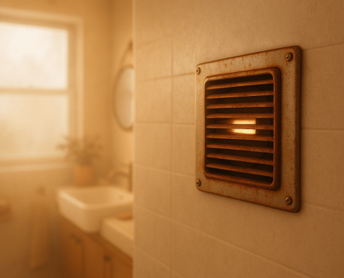

4. Fan Housing Not Properly Sealed
If water collects around the fan housing itself due to poor insulation or duct issues, it can leak through gaps in the housing or ceiling cutout.
What it looks like:
- Leaks from the ceiling but not from the grille
- Water-stained drywall around the fan box
- Signs of corrosion or rust on the metal fan frame
Why it happens:
- Gaps around the housing where air and moisture escape
- Missing or ineffective ceiling vapor barrier
- Inadequate sealing or insulation around the fan
