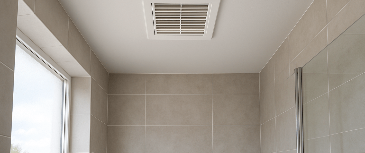

Installing a bathroom exhaust fan may seem simple, pick a spot on the ceiling, wire it up, and let it run. But there’s more to proper installation than just convenience. Where you install your bathroom fan plays a big role in how well it removes moisture and odors, how safely it operates, and whether it meets building codes and manufacturer recommendations.
This article will help you understand installation zones for bathroom fans, what they are, why they matter, and how to make sure your fan is placed for optimal performance and safety.

The Basics of Bathroom Fan Placement
Most bathrooms are divided into zones based on their proximity to water sources. These zones help determine what type of fan can be installed in each area, especially when dealing with electrical safety near bathtubs, showers, or sinks.
Key goals for fan placement:
- Capture rising steam before it spreads
- Avoid direct contact with water spray
- Maintain code-compliant electrical safety
- Prevent heat buildup around the fan motor
- Allow easy access for future maintenance
