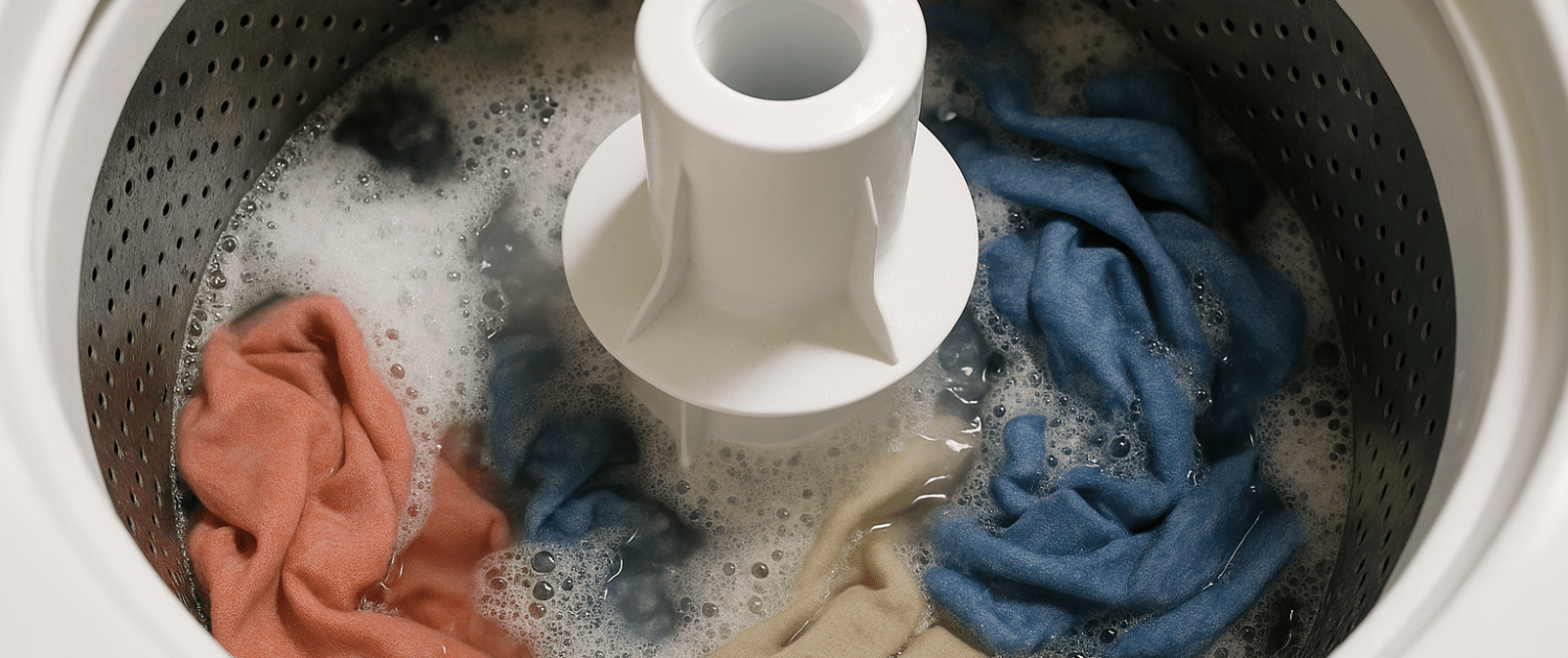

Whirlpool Top Load Washer Not Draining? Test the Drain Pump
Steven E / Tuesday June 17, 2025
A Whirlpool washer that won’t drain or makes odd noises can quickly turn laundry day into a hassle. We’ll show you how to spot a failing drain pump, why it happens, and how to test and replace it—no costly service call is needed.
