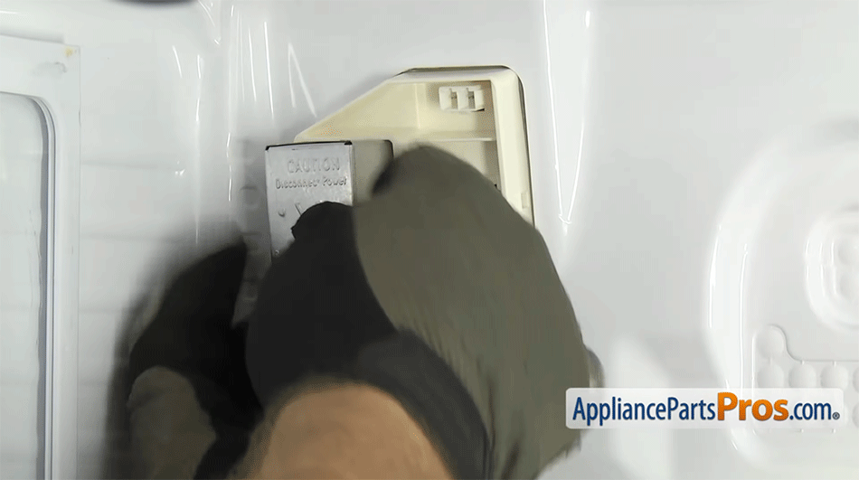

- Disconnect your refrigerator from power, either at the wall outlet or by flipping the circuit breaker. This is crucial! Do not perform maintenance on an appliance that is still receiving power.

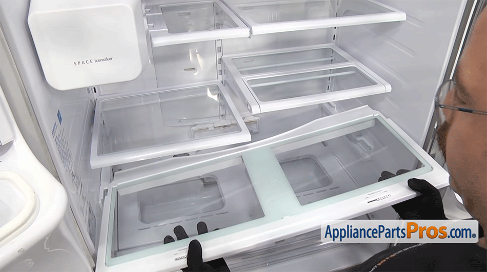

Step One: Remove all shelves and drawers
We’re starting off assuming you’ve already cleared out your refrigerator’s fresh food compartment. So, your first step is to get those shelves, drawers, and supports out of the way.

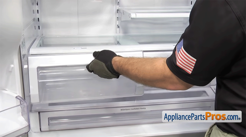

- For the drawers, pull them out until they stop and then lift up slightly to dislodge them from their brackets.

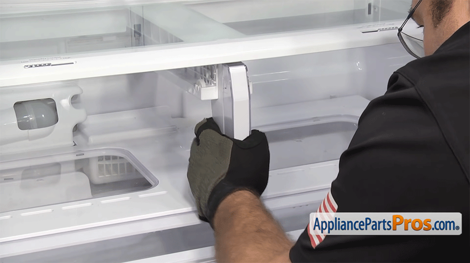

- Remove the center divider between the drawers, next. It’s held in place by locking tabs on either side.
- All the shelves can be removed by lifting up on the front and carefully sliding them out.
- The ice maker stays in place. Just push the shelf attached to it up and lean it against the ice maker for now.

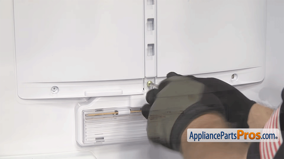

Step Two: Remove the screws holding the back panel in place

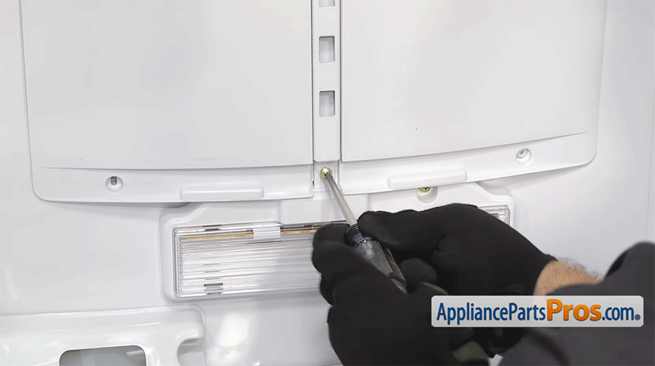

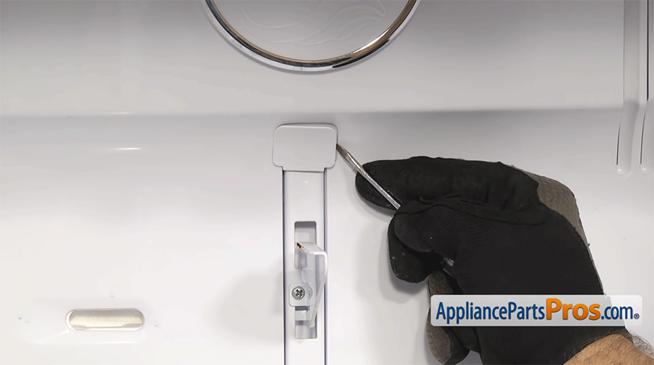

The back panel is held in place by four screws, the first of which is hidden behind a small cover near the top of that panel. You’ll need to use a flathead screwdriver to pry the cover off to reach that first screw.
Once the cover is off, you can remove all four screws – three on the bottom and the one near the top – with a Phillips screwdriver.

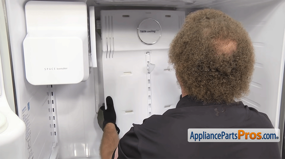

Step Three: Remove the back panel
Starting from the bottom, dislodge the back panel from the back wall of the refrigerator, carefully working your way up. It will be held in place by some wires at the top, so don’t yank it away.
The wires are connected to the refrigerator proper by a couple of locking wire harnesses. You can disconnect those by hand by pressing on the tab. Once both are disconnected, you’ll be able to remove that back panel assembly. Set it aside.

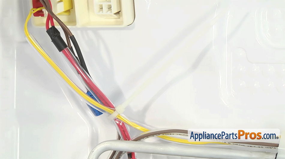

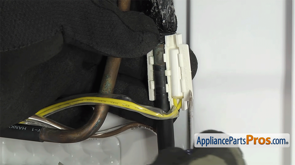

Step Four: Free up the old temperature sensor

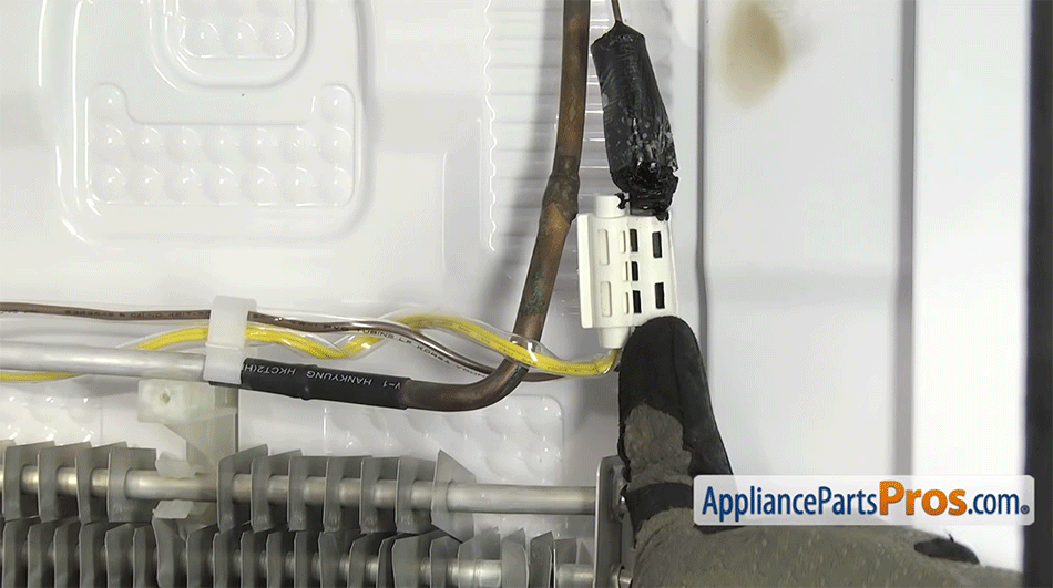

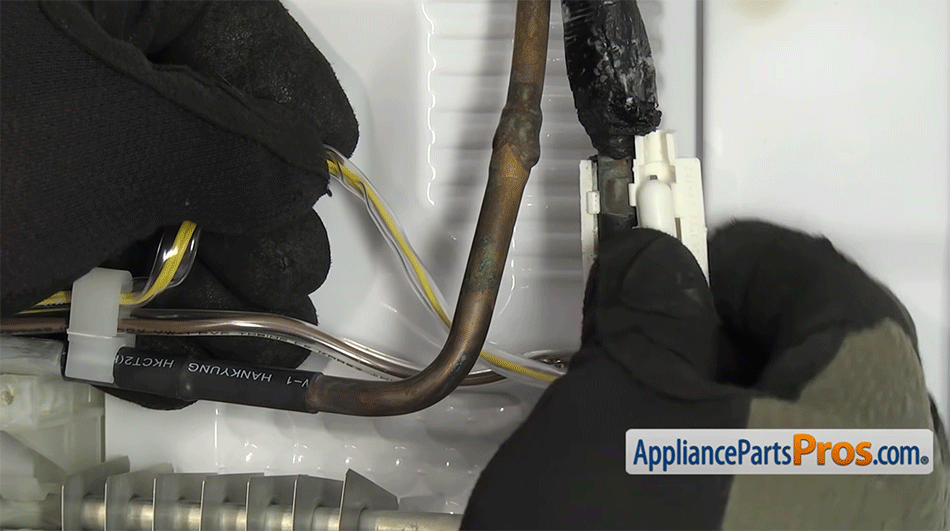

The old temperature sensor is mounted in a plastic bracket just above the evaporator coils. To get the old sensor out, carefully turn the bracket so that you can see where the sensor probe is snapped in, then use a flathead screwdriver to pop it out. Be mindful of the copper pipes around the sensor when doing this – damaging those in any way will turn a quick, easy repair into an expensive and potentially dangerous one.

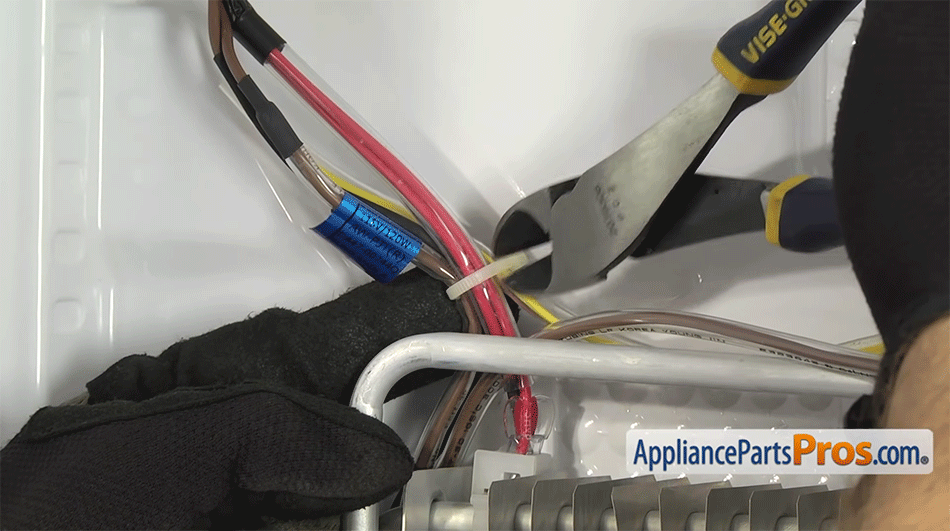

Once the sensor is popped out, follow the wire and unclip any clips holding it in place. You may need to use your wire cutters to snip one or more zip ties bundling wires together, also.

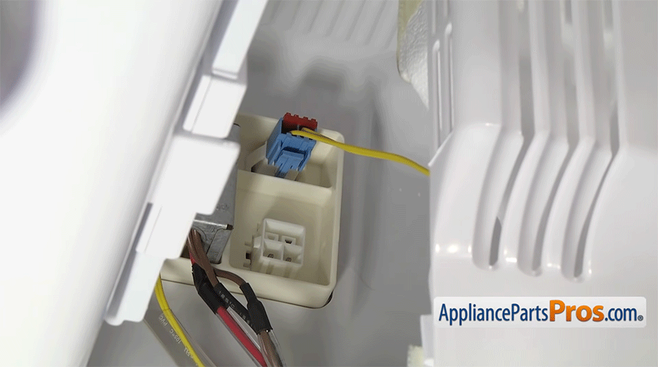

Continue following the wire up to its harness. This will likely be beneath a metal cover, which you can remove by hand. The harness block itself is held in place by another locking tab. Press that to disconnect it.

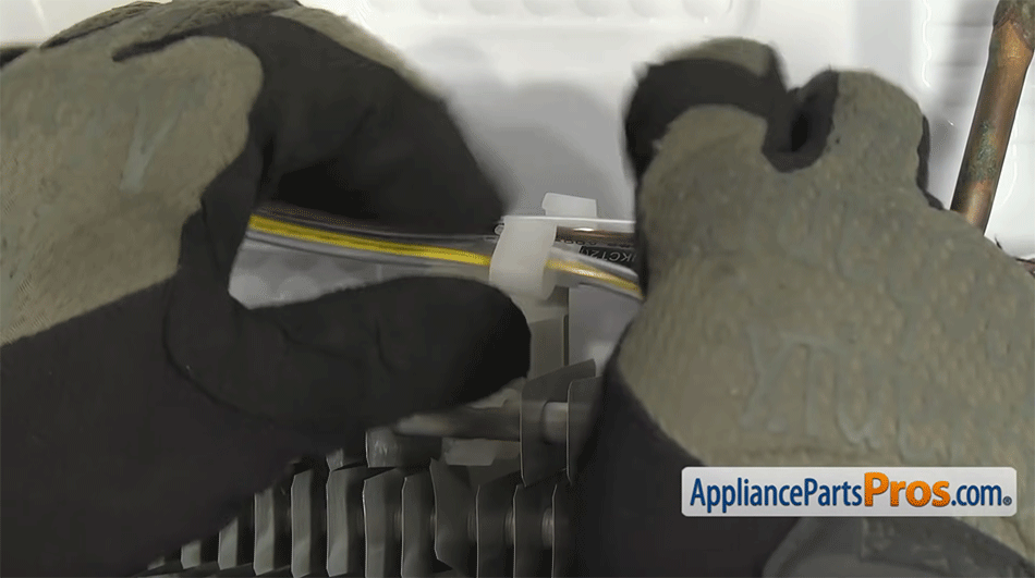

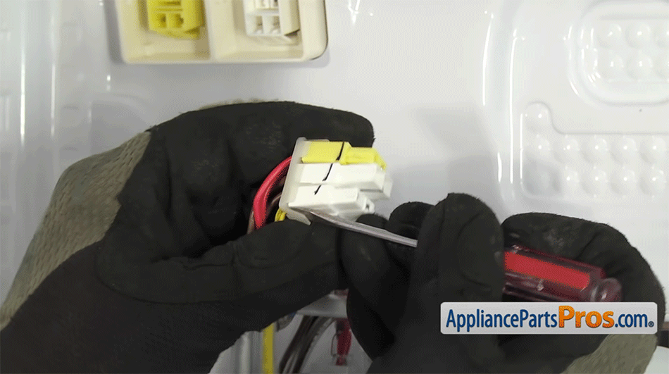

Step Five: Disassemble the wire harness block

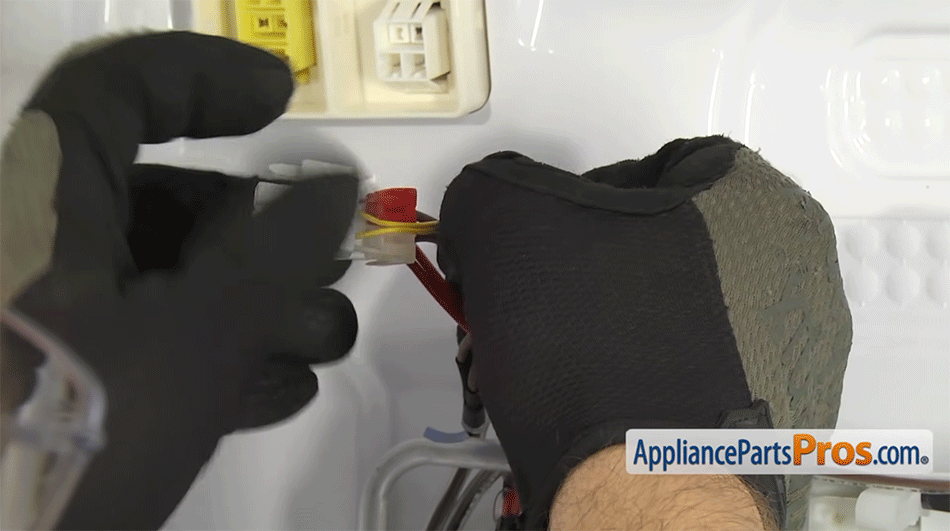

To completely remove the old temperature sensor, the wire harness block you’ve just removed will need to be partially disassembled. Use your flathead screwdriver to pop the tabs holding it together off. You need only remove the temperature sensor’s harness. All the others can be left in place.
Step Six: Connect the new temperature sensor’s wire harness
Time to snap the new temperature sensor’s wire harness to the harness block. To do this, slide the wire between the red and white locking tabs, then pull the plastic harness part into place. It should snap in.
Once you’ve done this, you can plug the harness block back in.
Step Seven: Route the new sensor’s wire into place
Feed the sensor wire through the plastic clip that was holding the old one in place, making sure to close the clip and turn it back into the up position. Next, run the temperature sensor probe behind that copper tube, then snap it into place in its holding bracket. Once it’s secure, you can turn the bracket back over to the position it was in when you started working.
Once it’s snapped into place, adjust it so that it’s not too slack on either end and remove any loops or serious kinks in the wire. When well positioned, you can secure the wires together again with a new zip tie. Be sure to cut off the excess with your wire cutters.

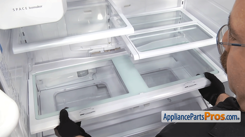

Step Ten: Reinstall the shelving
The upper shelves are reinstalled in basically the same way. Set them in back first, making sure that they’re hooked in place before lowering them down into place. Once the upper shelves are in, you can flip the ice maker shelf back down, as well.
For the crisper cover shelf, you may need to slide it into the fridge at a slight angle. Set it down on the rails, holding up a bit at the front, then slide it back. The shelf should slip under the rails and click into place. Once this is done, you can snap the shelf support into place by hand.
Finally, reinstall the drawers. The wider drawer goes on the left. You may have to install them at a slight angle, with the front tilted up.
