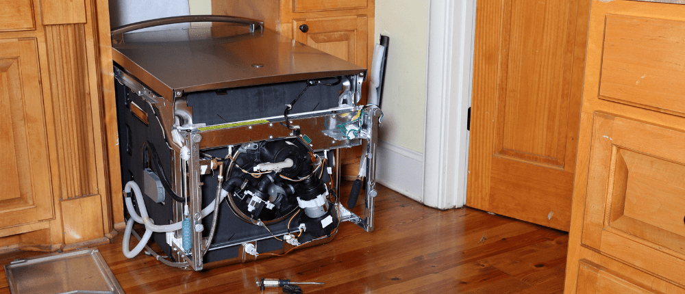

Dishwasher leaned over in kitchen to replace circulation pump and motor

Access the Pump and Motor Assembly
Once on its back, locate the pump assembly attached to the housing inside the bottom dishwasher interior. A small flathead screwdriver releases the wiring harness clip and tug line free. An alternative screwdriver then bends the non-reusable clamp holding the inlet hose, releasing its locking tab. Finally, gently pull down on the pump assembly to detach its mounting tab from the housing base.
Install Replacement Pump and Motor
Inspect and compare the replacement pump motor assembly to the extracted old one. Wet rubber gaskets on both the new pump and sump housing aid smooth insertion. Line up locking tabs and press the pump fully into place. Fasten the inlet hose securely using a reusable screw clamp. Finish by reconnecting the wiring harness plug.
