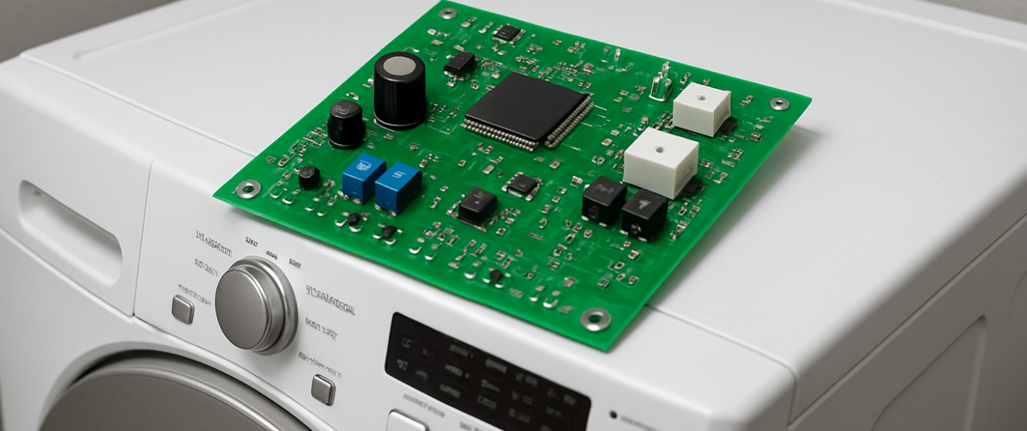

How to Test and Fix Whirlpool Washer Main Control W11553797
Steven E / Tuesday June 17, 2025
Washer acting up with random stops, error codes, or refusing to start? If you own a Whirlpool or Maytag model, the main control might be to blame. This component is the brain of your machine, and when it malfunctions, so does everything else. Before you call in the pros, let’s break down the signs that scream it’s time for a replacement.

How to test and replace the Whirlpool or Maytag washer’s main control
Below are the steps to access, remove, and replace the main control board in a Whirlpool or Maytag washer. Follow them carefully to complete the process safely and correctly.
Step 1. Access the main control
- Unplug the washer from the electrical outlet.
- Remove the two screws from the rear of the console.
- Open the washer lid.
- Use a putty knife to press back on one corner of the console to lift it slightly.
- Insert the putty knife between the top panel and the console.
- Push the putty knife toward the rear to disengage the clip holding the console.
- Lift up on the console while keeping the putty knife in place.
- Repeat the process on the other side to fully release the console.
- Once the console is popped up, close the washer lid.
- Tilt the console forward to access the main control board.
Step 2. Remove the main control
- Turn off the water supply to the washer.
- Take a picture of the wiring harness connections for reference.
- Disconnect each of the wiring harness connectors from the main control board.
- Disconnect the pressure hose from the control board.
- Remove the screw securing the main control board to the washer.
- Slide the main control board to the left to disengage it.
- Lift the control board out of the washer.
Step 3. Install the new main control
- Lower the new main control board onto the washer.
- Slide the control board to the right to lock it into place.
- Install the screw to secure the control board.
- Reconnect all wiring harness connectors using the reference picture.
- Reconnect the pressure hose to the control board.
Step 4. Reassemble the console
- Flip the console back up into position.
- Press down on the console until the clips snap into place.
- Plug the washer back into the electrical outlet.
- Verify that the washer powers up.
- Do not unplug the washer or press any buttons for at least five minutes to allow communication with the user interface.
- Reinstall the two screws at the rear of the console.
- Turn the water supply back on.
- Confirm that the washer is functioning correctly.
