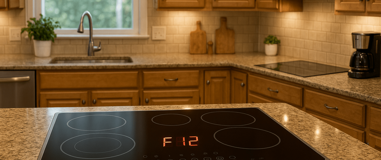

Your KitchenAid cooktop is flashing the F12 error code? Don’t worry, it’s not the end of your stovetop. We’ll walk you through what causes the F12 error and how to troubleshoot and fix it yourself, no need to call in a technician.

The F12 error code indicates a communication error between the touch control module and the main power control board in a KitchenAid induction cooktop.
These two power control boards must connect properly and pass signals back and forth for the cooktop to operate correctly:
  • The touch control module contains the circuitry and sensors behind the glass touch keys. It sends input signals when a user presses a touchpad on the user interface.
  • The electronic control board receives these input signals and controls element operation. It sends output signals back to the touch module to activate display LEDs.
An F12 fault occurs when the signals between these two components are disrupted. Possible causes include:
  • Damaged or unplugged ribbon cable between the modules
  • Loose wiring connections at terminals
  • Defective touch control or electronic control circuitry
Left unresolved, the F12 code will lead to partial or complete failure of cooktop operation. The heating elements will not activate and the touch keys may be unresponsive.
