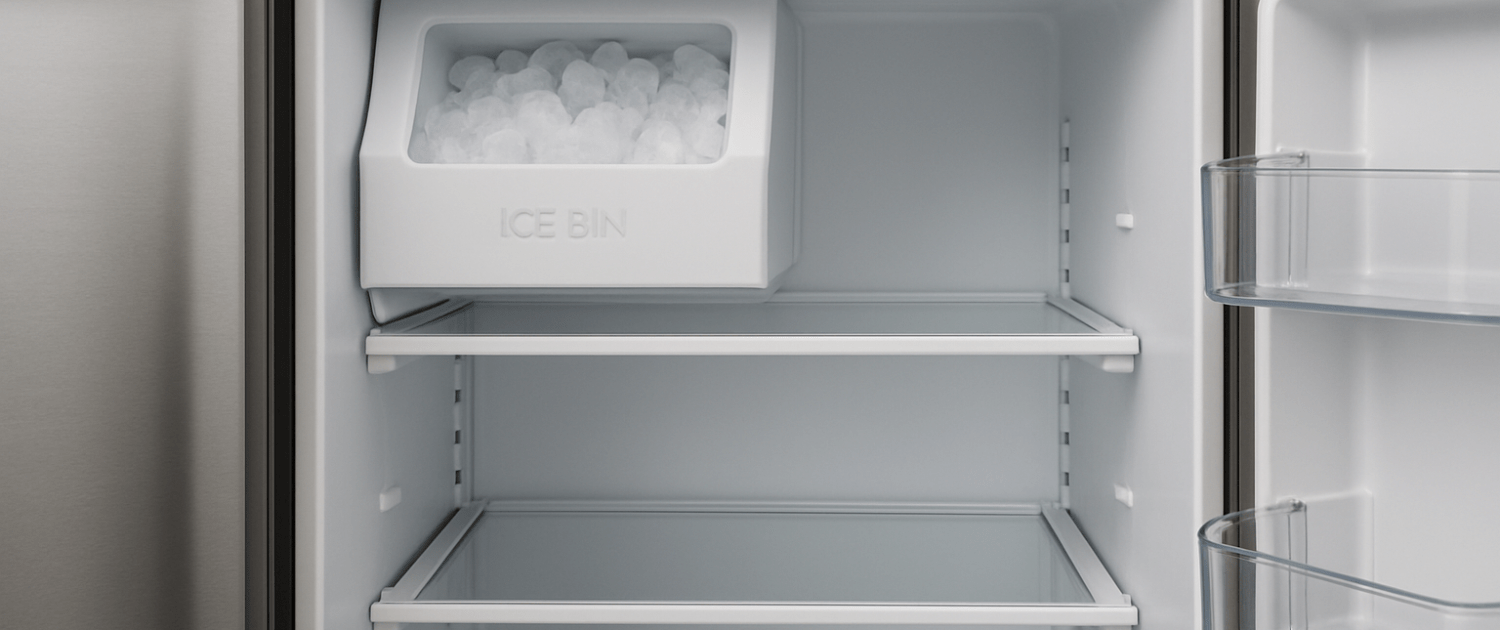

- Open the freezer door.
- Press down on the latch to open the ice bin.
- Lift the ice bin straight out to remove it.
