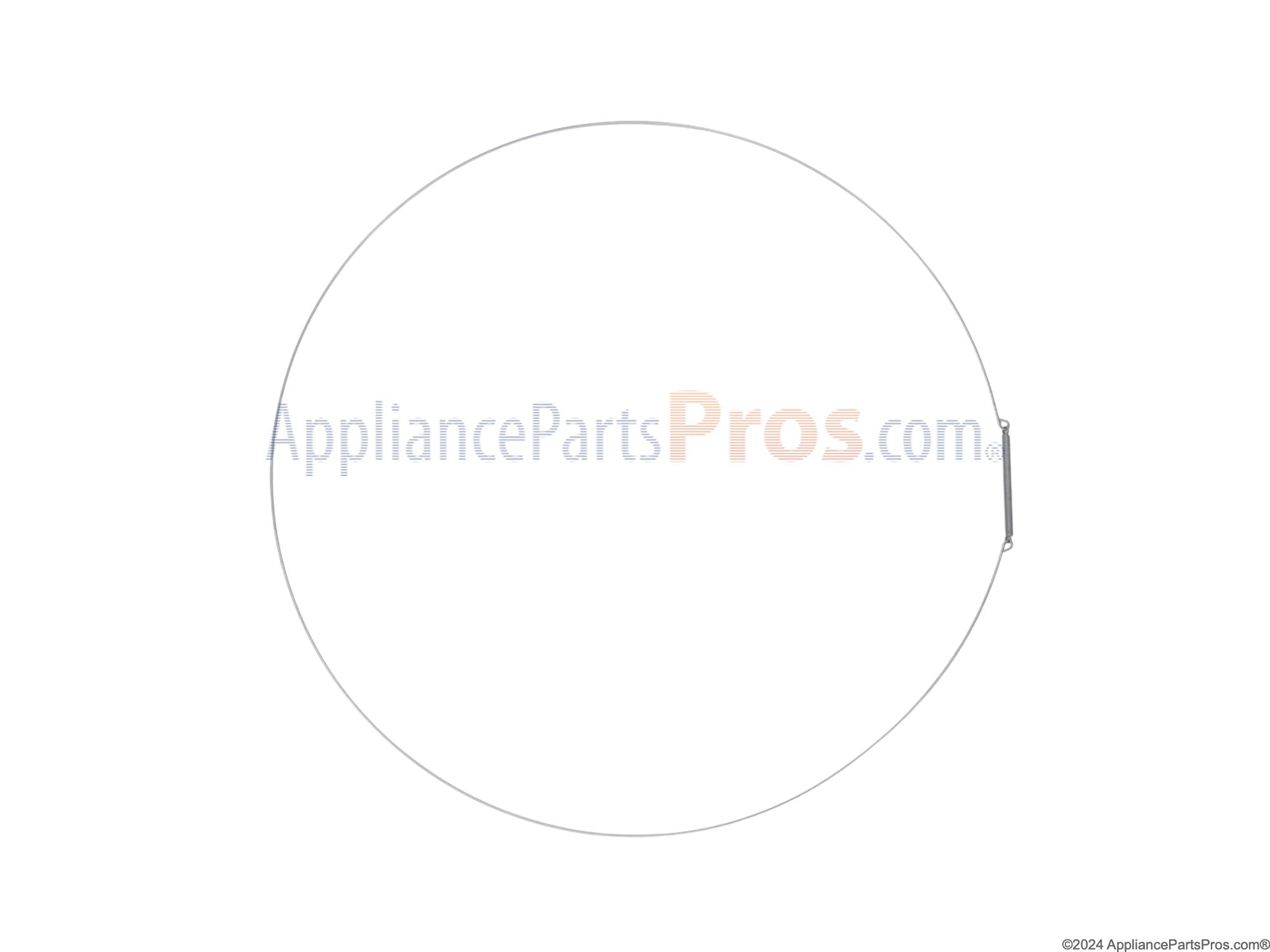

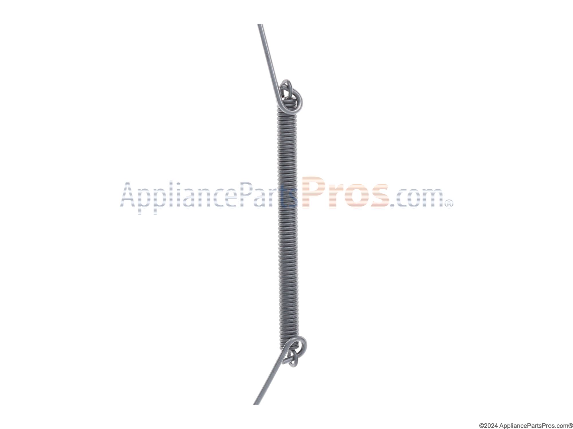

Doug S Atlantic Highlands , NJ October 01, 2017 Appliance: Model WFMC8440UC/15 Bosch next series 800 washer boot replacement I saw a tube video of a guy that replaces the boot without taking any of the washer apart. The boot was no problem, I had the old one off and the new one on in 20 minutes... The rear wire/spring clamp I found impossible to do. the spring is so hard to stretch. I tried till both of my thumbs were bleeding from the pressure. So I took off the top control panel, had access to the top of where the boot clamp groove is. I took one end of the wire off the spring, lubed it up with dish soap, put it around the bottom and sides and stretched the spring enough holding the end of the spring with one side of small needle nose pliers and vice grips on the wire part. It literally took all my strength to stretch that spring about an inch and a half to connect to the wire. Rear clamp done. The front wire clamp was just as hard, so I took the old rear clamp which was longer and made a new front wire clamp that I only had to stretch the spring about an inch. Bosch has those springs ridiculously tight. Read More... 12 People found this story helpful Do-It-Yourself Rating: Repair Time Estimate: 2+ hours Tools: Pliers
Allen F Centennial , CO May 07, 2022 Appliance: Model WFVC540SUC/29 Door boot gasket (door gasket) started to leak missing a chunk near the bottom. This was the first problem with our Bosch 500 series front loader in 11 years! Boot gasket and clamps arrived quickly and were the correct parts. Removed washer top and control panel OK but bottom front access panel was just a plastic snap on affair and I broke off one of the tabs when pulling off. Why can't they just use a couple of screws instead? Once the access panel was off the door came right off and the old boot gasket (lots of yucky stuff on the inside) came out. New boot gasket fit nicely on the drum and the inner spring clamp went on easily. The outer spring clamp for the door was a real pain, finally needed another pair of hands to assist and lots of arm strength to pull spring open enough to seat it properly. Washer is like new, runs great! Worth the effort. Just need a star drive screwdriver. Read More... 1 People found this story helpful Do-It-Yourself Rating: Repair Time Estimate: 1-2 hours Tools: Screwdrivers
Luis G South Pasadena , CA July 06, 2020 Appliance: Bosch Washer WFMC6400UC/01 The boot gasket has mold was really bad I ordered the parts, watched a video of how to do it, I saw it was kind of difficult, and having no experience in these kind of fixings, I called a friend to help with the difficult part, which is mainly the big clamp and the small clamp, that made my job really easy, and the results were perfect, the parts worked well. I didn't know the boot came with the two clamps, and I've ordered the clamps separately, so now I'm going to have to returned them. That was my only inconvenience. Read More... 1 People found this story helpful Do-It-Yourself Rating: Repair Time Estimate: 1-2 hours Tools: Pliers, Screwdrivers, Socket Set
Jeffrey N Meriden , CT July 24, 2023 Leaking door gasket. Took the top off and the front. Removed the two clamps to gain access to the door boot. Remove the old boot and Installed the new one. Works good Read More... Do-It-Yourself Rating: Repair Time Estimate: 1-2 hours Tools: Nut Drivers, Pliers, Screwdrivers
Jane W Grand Blanc , MI October 29, 2018 Appliance: Model WFMC22O1UC/15 Door gasket was leaking. Bought a new door gasket an new rings in case they were rusted out. It was easy to install the rubber door gasket .The rings was very difficult to get back on, but finally got it on. That took the longest. Read More... Do-It-Yourself Rating: Repair Time Estimate: 1-2 hours Tools: Pliers
