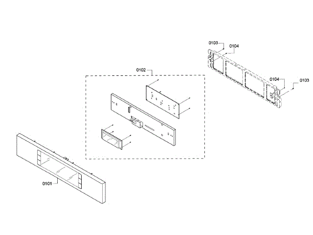

Katalin M Kenmore , NY October 07, 2021 Appliance: Bosch Microwave Oven HMC87151UC/01 Fading LCD indicator on Bosch hmc870151uc/01 speed oven microwave Since the control board (the circuit board) itself was not available separately, I used this complete unit to replace the entire control panel block. The layout of the circuit board in this unit is slightly different from the original, so it comes with instructions on how to re-route the cables for the connectors to make it work. It is not a big deal, there is enough slack in the cables, you just have to open some wire ties on the bundles and then place new ones once you completed the connections. The print on two buttons have changed, but it is not significant, instead of "Auto Chef" this has "Speed Chef", and instead of "+30 sec", this one has "Microwave +30 sec". The replacement is easy, once you pull the unit out of the cabinet. Just take off the top (simple screws), remove the connecting wires, then remove the 5 screws holding the panel, and the panel comes off from the front. You need to tip out the top and then pull, as there is a clip in the middle of the bottom edge. Put in the new panel, then complete the connections based on the instructions. Pay attention to the 5 large colored connectors, they are in reversed order compared to the old board. They were a bit difficult to push back onto the prongs. The other connectors only have one place each where they fit. This is all explained in the instruction sheet that you should receive with the part. The new unit comes with blue foil protector for the front, I suggest you start peeling that off at the edges before you install the unit. Read More... Do-It-Yourself Rating: Repair Time Estimate: 30-60 minutes Tools: Screwdrivers
