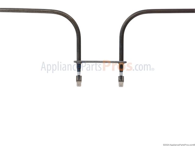

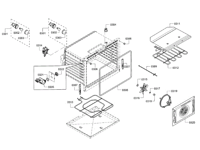

David B Denver , CO February 12, 2022 Appliance: Bosch Electric Range HIIP055U/01 A loud buzz followed by plume of smoke; then no heat at all. Based on the sound of arcing, one of the elements failed. The upper one tested fine; too bad, as that's the easy one to access. The lower element on my Bosch induction range is accessible from the back, but only after you pry and bend a vertical piece of sheet metal down to a 30-40 degree angle. I assume this saves Bosch a few cents on each unit during production. Before bending that panel down, I remove all vertical obstructions: 240V power cable, the wires to the warming drawer element (spade terminal lugs), and temperature sensor (small white clip in the middle of the wiring harness). I also unscrewed the control board from the back and temporarily held it out of the way with some scrap wire running to the frame above. Behind that bent panel is where the element and a metal tray that is resting on top of dense fiber insulation. There is more insulation running down the back inside panel, and I pushed that upwards for visibility and access, and then found my element had welded itself to the metal tray. I pulled both out far enough to cut the weld loose with a Dremel tool (no amount of prying would break the weld). That tray has two notches on either side that fit around a flange on the oven cavity, so you have to use a tool to pry the tray downwards while sliding it out to get past that. After using the Dremel to remove more large welded debris from the tray, I inserted the new element. There are clips in the tray that secure the bottom rods of the element; make sure to lift the front rod over the rear clips when sliding it in. Then slide the tray back past that flange again, and with a helper holding the oven from sliding around, muscle the "access panel" back into something close to its original right angle bend. Have your helper screw one screw in at a time as you hold that piece in place so the holes line up. Then reconnect all wires and re-mount the control board. When testing to see if it worked, note that the oven makes all the clicks and whirs like it's working, but doesn't actually heat up the elements if the door is open. Just push the door switch plunger in and you'll quickly feel warmth (be careful, obviously; I felt more comfortable testing this way than probing the 240V terminals on the back). Support at AppliancePartsPros.com didn't have a service manual (I doubt Bosch lets those out) but did find a YouTube video that got me close. I have since posted my own video (still images with text) on YouTube if you want to see pictures; searching for HIIP055U lower element should get you there. Good luck; great oven otherwise, and another good experience with AppliancePartsPros.com. Read More... 4 People found this story helpful Do-It-Yourself Rating: Repair Time Estimate: 2+ hours Tools: Pliers, Screwdrivers, Wrench Set
John R Austin , TX January 11, 2026 Appliance: Model BOSCH OVEN HBN8451UC/03 Our bosch oven would not hold the set temperature after preheating Using AI help, we determined that the Bosch oven has an upper and lower heating element. Both are used for preheating, but the lower element keeps the oven at the set temperature. Since the oven wasn’t keeping temperature it was likely a burned out lower heating element. We turned off the power to the unit, removed the door and removed the oven from the wall. We disassembled the lower part of the oven and replaced the heating element we bought from AppliancePartsPros.com. They shipped same day and I received it in 2 days. It is an OEM part, which is what I wanted. Reassembled and reinstalled and now works great. Read More... Do-It-Yourself Rating: Repair Time Estimate: 2+ hours Tools: Pliers, Screwdrivers
Jeffrey B Alpena , MI December 31, 2024 Noticed preheat would take very long time and nothing quite cooking thru in reasonable time Ordered new lower heating element, watched some you tube videos and cut power , pulled out and replaced. Old element visibly cracked and broken Read More... Do-It-Yourself Rating: Repair Time Estimate: 1-2 hours Tools: Screwdrivers
Robert S Forest , VA June 25, 2026 Slow preheat Eventually determined the cause of the problem was a broken lower element which is concealed under the bottom of my Bosch Wall Oven. Finally I was able to make arrangements for someone who knew what he was doing to remove the old element and install the new. This was a two man job as we had to remove multiple outer panels to finally get to the element location. Once we had access. removing the old and installing the new was easily completed. Then we had to reinstall the panels and pieces that had been removed to gain access. Reinstalled all of the panels was not difficult, but was time consuming. Once everything was buttoned up and the wall oven had been reinstalled into the wall, we flipped the circuit breaker and then did a preheat. The preheat reached temperature quickly. This repair by just one person would have been difficult because the wall oven had to be removed from the wall and then flipped on its side and then the next side, and the oven was cumbersome and heavy. With 2 of us the repair was easy, but time consuming. Read More... Do-It-Yourself Rating: Repair Time Estimate: 1-2 hours Tools: Nut Drivers, Screwdrivers
Jeffrey W Harrison , ID August 20, 2023 Failed oven heating element. Replaced with a new element from AppliancePartsPros.com. Easy fix all went well. had pizza last night and it was amazing. thanks AppliancePartsPros.com. Read More... Do-It-Yourself Rating: Repair Time Estimate: 1-2 hours Tools: Screwdrivers
