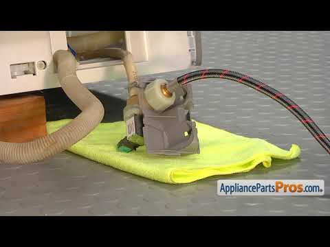

Dawn P Everett , WA February 14, 2023 Appliance: Bosch Dishwasher SHX68T52UC/02 E 15 error message; Bosch dishwasher Stopped running mid cycle. I found a slow drip coming from the water inlet valve. This was the source of the E-15 message. The water collected around the styrofoam disk, which then tripped the leak sensor. It was easy to replace the valve, following the video instructions. At the same time, I decided to replace the two door seals, due to periodic leaking in the front of the dishwasher. The lower door seal replacement procedure was long, but the video was very helpful and thorough. The larger, upper door seal was very quick to replace, but there was one problem. The video did was not clear as to the proper orientation of the blade seal with respect to the seal taper. I first installed the seal with the taper pointing outwards. The result was leakage and noisy operation. I found a second source that specified a definite orientation of the seal; that the taper should be pointing inwards. After turning the seal around, the leaking stopped and the dishwasher ran quiet. Success! I suggest that you update your installation video for the upper door seal to make this more clear. Thanks. Read More... 11 People found this story helpful Do-It-Yourself Rating: Repair Time Estimate: 30-60 minutes Tools: Pliers, Screwdrivers
John R Hammondsport , NY July 03, 2020 Leaking water inlet valve, error code E15 Pulled out dishwasher, inspected, found water sensor doing its job sending E15 code. Found leaking water inlet valve. Replace valve, hose to side housing and the side housing itself due to clogging. It took 30 minutes to replace everything and works like new. Everything fit and couldn't ask for more. Read More... 3 People found this story helpful Do-It-Yourself Rating: Repair Time Estimate: 30-60 minutes Tools: Pliers, Screwdrivers
