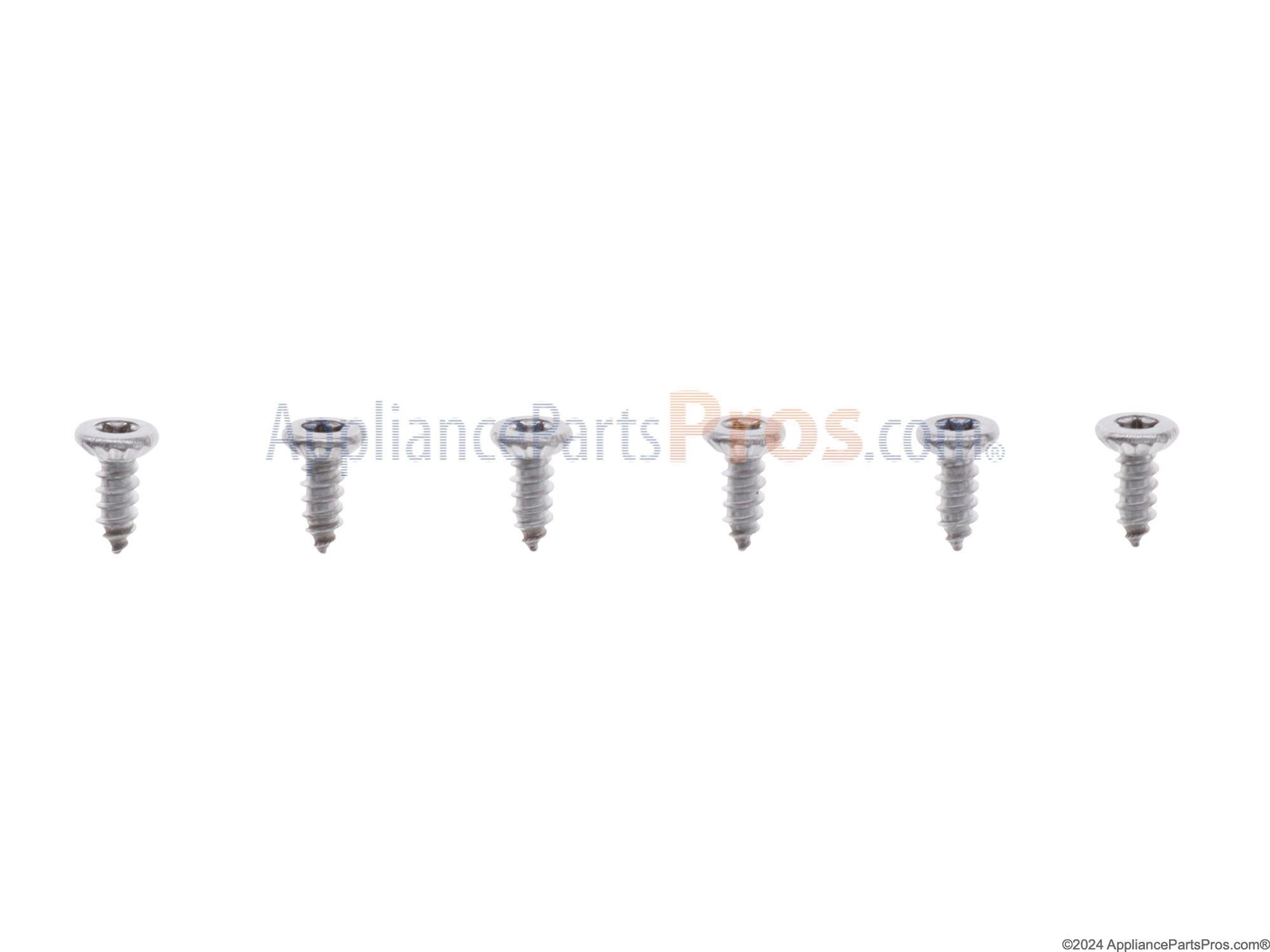

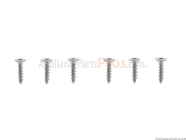

Leonard T Braintree , MA April 15, 2025 Appliance: Model BOSCH SHPM65Z52N/20 Screws had fallen out of the metal frame around the inner dw door I had removed the frame some time ago to deal with a different issue. It turns out there are two types of screws. Apparently, when I replaced the screws, I did so randomly, and some did not quite fit the holes, and fell out and were lost over time. There are longer screws, 022 on your diagram, that fit the UPPER three holes in the dishwasher door frame. The shorter screws, 023 on your diagram, fit the lower three holes on the dishwasher door frame. The screw heads are the same, but the threads are different. (BTW, I ordered the screws with routine shipping Friday afternoon and they were delivered by FedEx Saturday morning!) Read More... Do-It-Yourself Rating: Repair Time Estimate: Less than 15 minutes Tools: Screwdrivers
