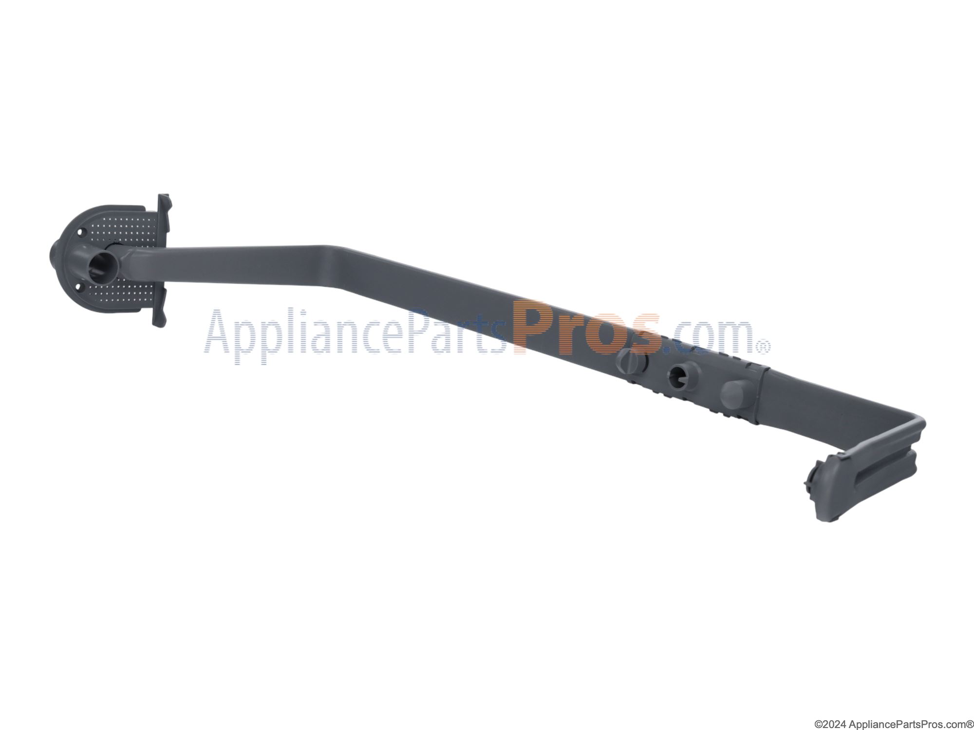

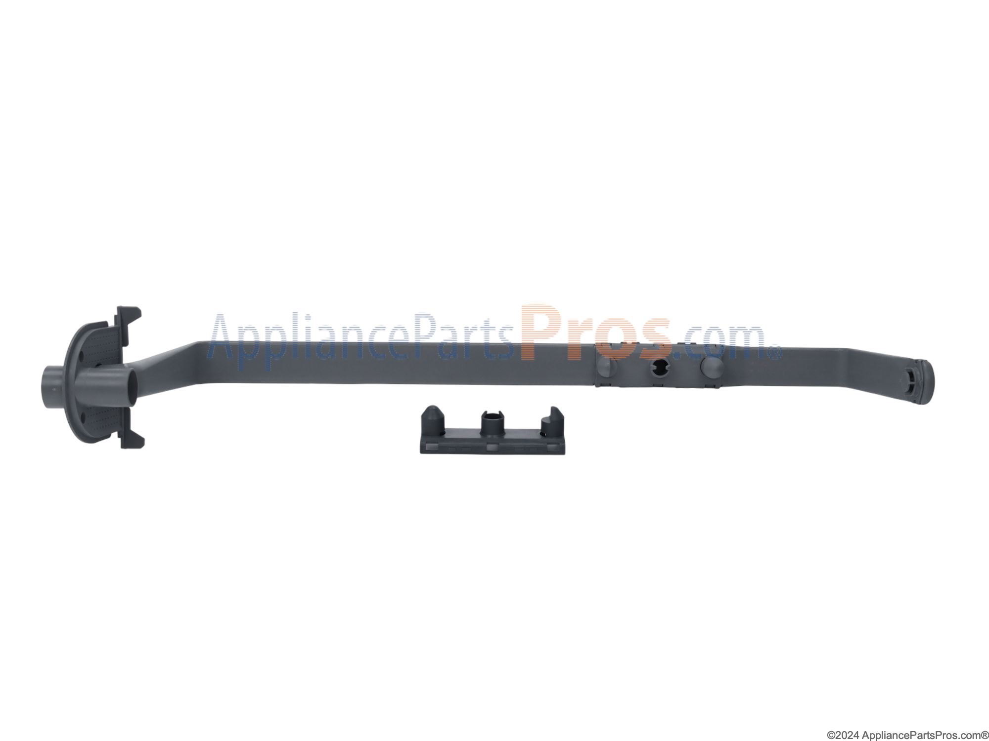

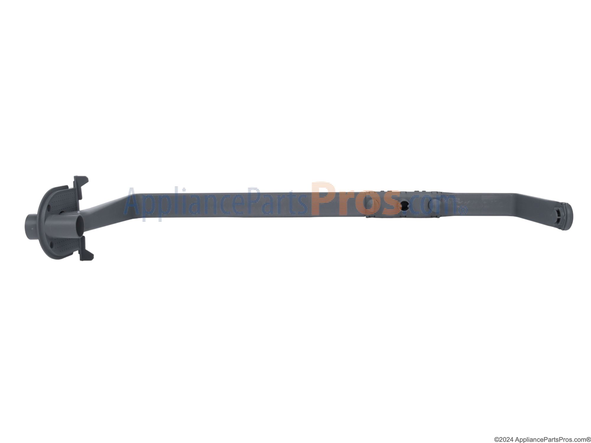

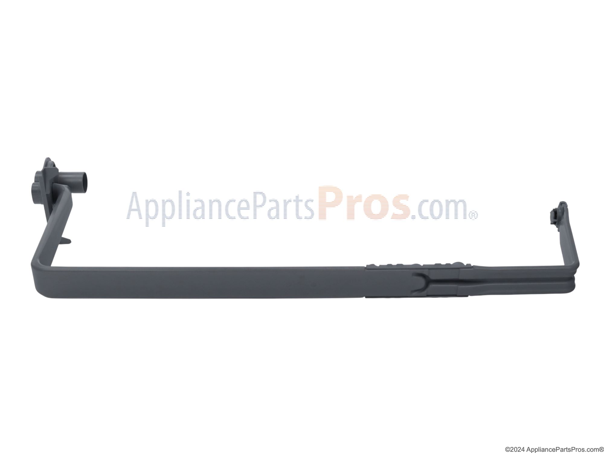

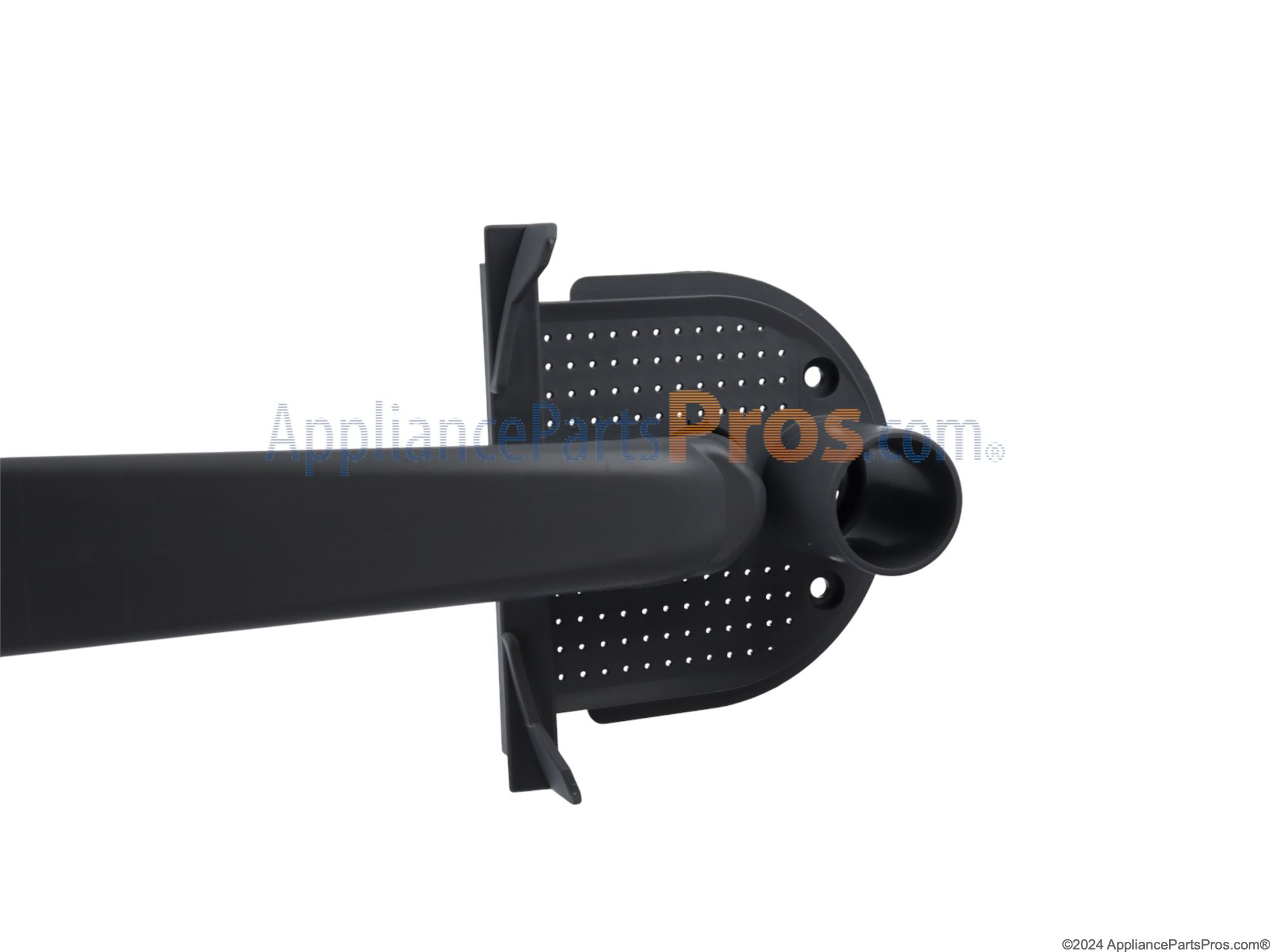

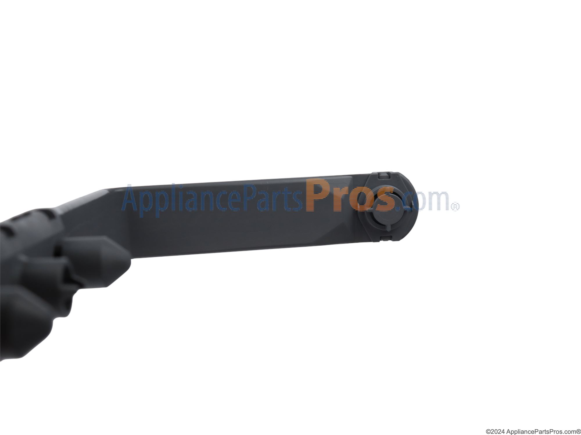

Dorman P Ponte Vedra Beach , FL October 18, 2014 Appliance: Model BOSCH SHY66C05UC/14 Dishes were not getting clean After we saw that progressively our dishes were not getting clean we investigated the condition of the spray arms and this upper feed tube assembly. We found a huge crack on the side of this piece and new not enough water was getting to the arms. We also noticed a build up of soap and lime. So we ran a cycle of vinegar and sprayed the filters and arms with lime-off-sprayed them out with a air hose "completely". Many of the small pieces of lime will clog the holes in the spray arms. Attached the new upper feed tube and it is like we have a new dishwasher! no more coffee rings and starchy plates and glasses. Clean Clean sparkling dishes! I continue to get quick dependable service from Applianceparts Pro-even if I find it cheaper elsewhere, I always buy here because I get it lightning fast and always the right part. ( torx screwdriver needed) Read More... 4 People found this story helpful Do-It-Yourself Rating: Repair Time Estimate: Less than 15 minutes Tools: Screwdrivers
C Michael H Boxborough , MA October 08, 2016 Appliance: Bosch SHU6805 UC/12 (FD 8003-) The dishwassher wasn't washing well for a while then suddenly one day it really did a bad job there was dirt on the bottom of the tub and mold growing everywhere seemed like overnight I took it all apart, right on down to the pump and impeller. When I started to clean up every part, I noticed that the upper feed tube had a crack in it near the bottom of the tub. This prevented water from going into the spray arms, and probably reduced the pressure going to the lower arm, causing it not to spin and wash. So I continued cleaning every part, channel, gasket, tube, etc, found that I also needed a filter basket, for a minor reason. I got the upper feed tube in a couple days, put the whole machine back together, and ran a load of dishes. Now everything gets cleaned and it all seems to work fine. Funny how a simple breakage could cause the whole thing to malfunction like it did. Read More... 1 People found this story helpful Do-It-Yourself Rating: Repair Time Estimate: 2+ hours Tools: Pliers, Screwdrivers, Wrench Set
Mckenzie M Lake Leelanau , MI October 19, 2019 Appliance: Bosch SHU9955 UC/12 (FD 8105 -) Not cleaning dishes in upper rack and water leaking from front door seals Replaced door seal and gasket, replaced water feed tube to upper rack and lower spray arm. Read More... 1 People found this story helpful Do-It-Yourself Rating: Repair Time Estimate: Less than 15 minutes Tools: Screwdrivers, Wrench Set

Joe S Ardmore , OK February 01, 2019 The upper water supply line was not sending water to the top of dishwasher Ordered replacement parts watched your video and it’s fixed Read More... Do-It-Yourself Rating: Repair Time Estimate: Less than 15 minutes Tools: Screwdrivers
