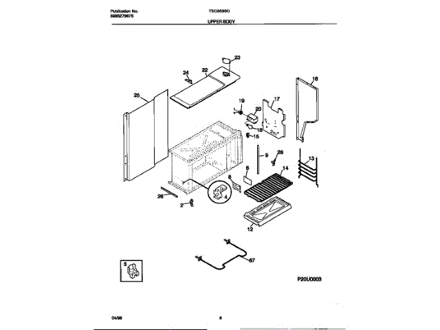

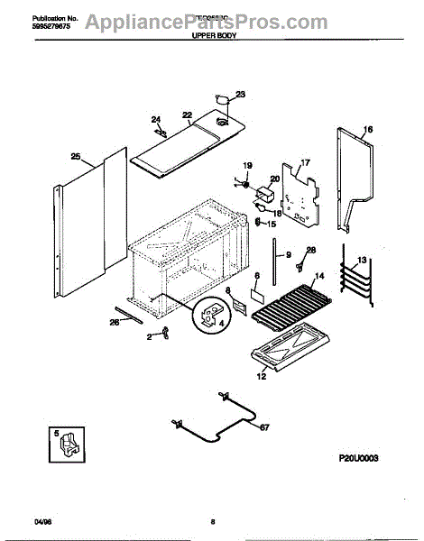

The bake element is the lower oven heating element that produces heat during bake cycles. Replacing a failed element restores proper preheating and even baking performance when your range no longer heats correctly in bake mode.
  • Provides bottom-up heat in bake mode to reach and maintain set temperatures
  • Typical symptoms include no heat in bake, excessively long preheat, or uneven/undercooked results
  • Visual clues of failure may include blisters, cracks, or burnt spots on the element
  • A shorted element may trip a household breaker when energized
What's included: 1 bake element
  • Disconnect power at the breaker before servicing; verify no power to the range
  • Remove oven racks; unfasten the element from the rear wall and gently pull it forward to access terminals
  • Transfer the wires to the new element one at a time; do not let wires retract into the rear panel
  • Reinstall and secure the element, ensure connections are fully seated and clear of metal, restore power, and test
