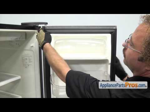

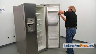

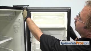

Duane D North Berwick , ME September 15, 2014 Appliance: Kenmore Side By Side Refrigerator 25351622100 Torn cracked refrigerator door gasket After finding the correct replacement part, I watched the installation video on the same page as the part description. I was curious as to how difficult the job was, as I had never changed a refrigerator door gasket before. The video showed a simple, but tedious procedure, so I went ahead and ordered the door gasket. As the video showed a somewhat lengthy process, I prepared by cutting out a large piece of corrugated cardboard to tape over the door opening after I had removed the door. When the new gasket arrived I inspected it, but something seemed different, so I reviewed the installation video again. My new gasket's profile was different from the one in the video, but it's length and height were an exact match to my old gasket, so I threw caution to the wind and gently pried up one section of the old gasket. Sure enough, it matched the new gasket, but not the video. The job was actually easier and quicker than what was shown in the video. The gasket has a spline on the back which just presses into a groove in the door. Just pull the old gasket out of the groove in the door, lay the new gasket on the door and align it at all four corners, and press the spline into the groove with your fingers. I think that if I had to do it again, I'd dispense with the temporary cardboard door as well as the door removal, and just open the door, rip out the old, and press in the new. Read More... 15 People found this story helpful Do-It-Yourself Rating: Repair Time Estimate: 30-60 minutes Tools: Screwdrivers, Socket Set
