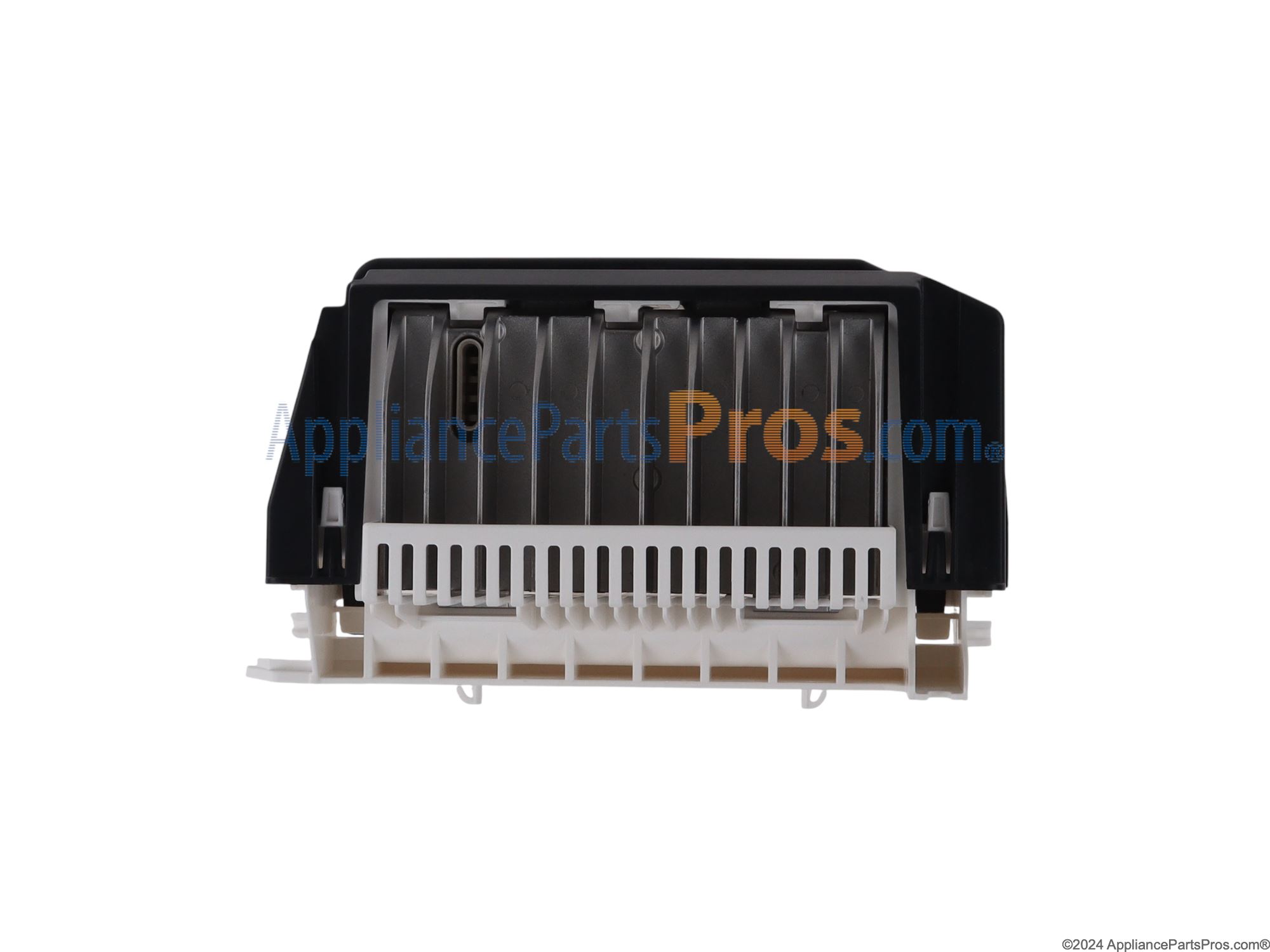

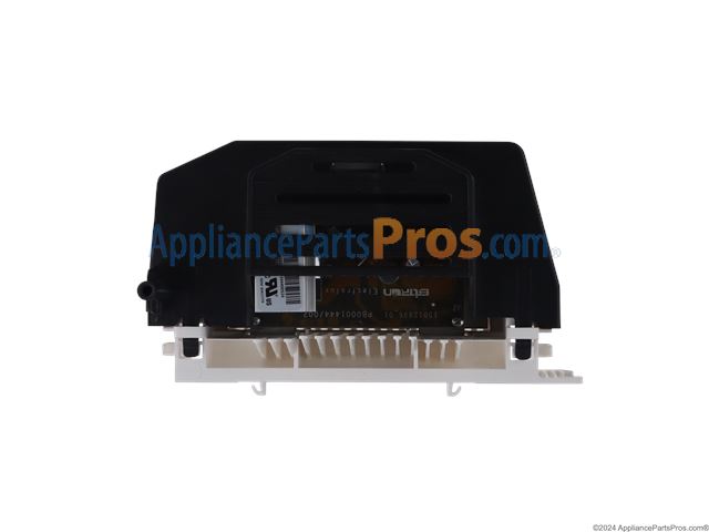

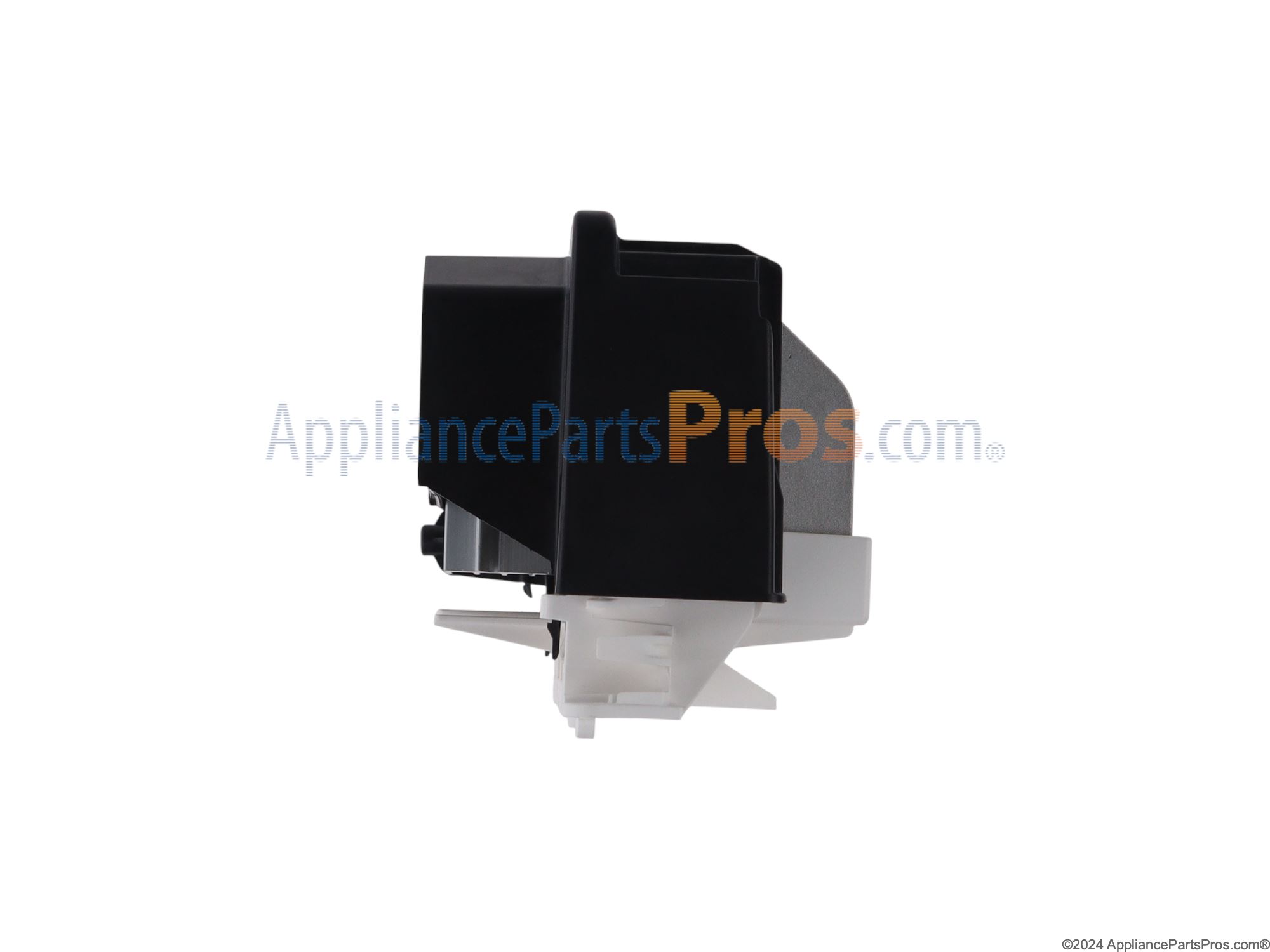

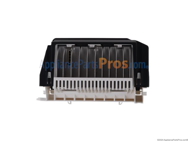

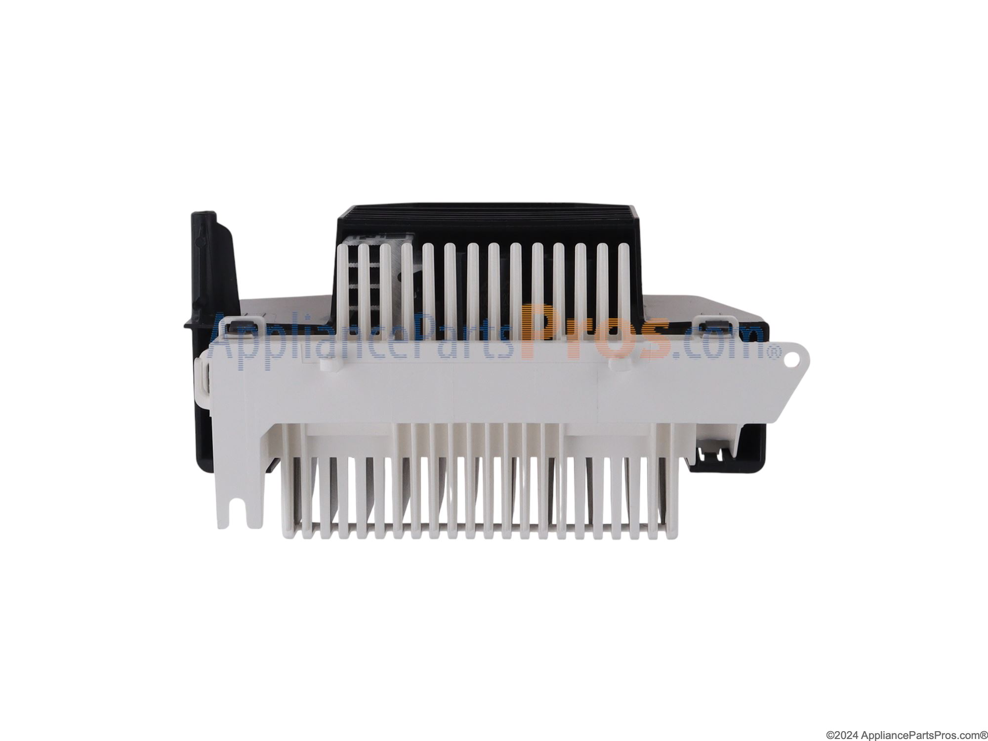

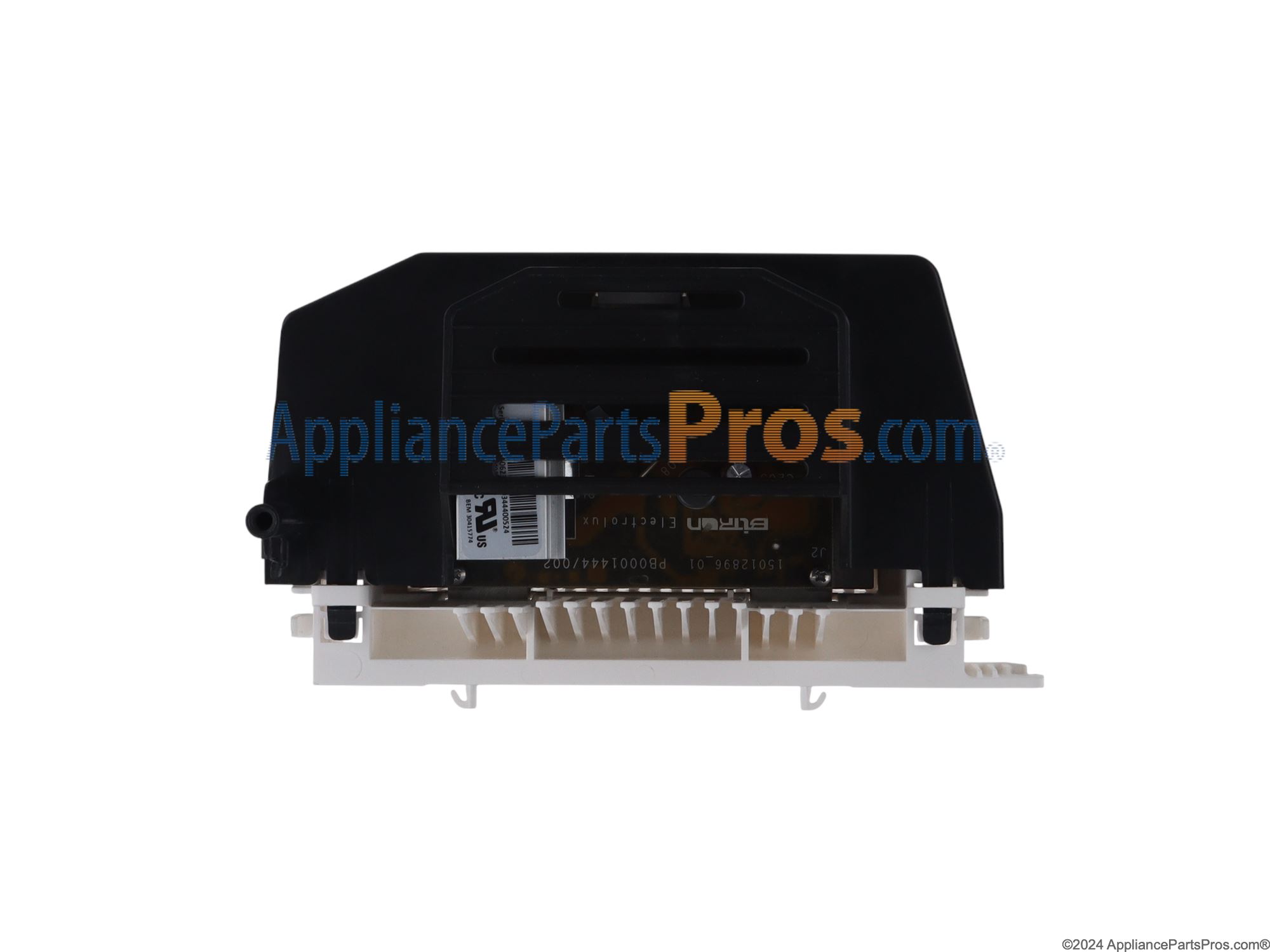

Stephen D 34 , NY October 01, 2021 Appliance: Electrolux Washer EFLS627UTT0 Basement flood caused damage to motor control board and drain pump Error code E5E on Electrolux EFLS627UTT0 (zero last digit) washer. Motor control board not communicating with main board. Error code E23, drain pump malfunction and E41, door lock malfunction. Removing front panel for drain pump replacement and rear panel for motor control board were more involved than the actual repairs (I also replaced the door boot seal while I had it open which was a pain but the two year old one had a tear in it and it was a bit moldy so I did it. The interior retaining spring was tricky getting back on, needed another set of hands to complete.) Before replacing the motor control board, I checked to make sure wires had continuity with the main board first (J-1 and J-14 on wiring diagram.) They did, so I replaced the motor control board which comes complete with black and white plastic housing pieces. 3 quick connections and closed up the back. I was tempted to try and replace it through the smaller oval service panel but thought better, would've been very difficult. The drain pump was easy to replace, it's located right behind the front panel, under the tub. I suggest having a few towels ready for the water remaining in the hoses. Used channel locks on hose clamps, wasn't too difficult. Made sure both hoses were in as far as they could be on new pump orifices. In hindsight I think the faulty MCB was causing the E41, door latch error code but I replaced it because I ordered a new one before I did a continuity check on the old one. (turns out the old one was good.) A few things in closing. I put the washer on a furniture dolly and wheeled it to the middle of the basement floor then transferred it to 4 plastic bed risers to get some elevation and I kept it on the dolly and made sure it worked before I placed it back on the floor and leveled it. I got ripped off by an HVAC company around 6 years ago and since then I vowed to repair everything myself or buy a new one, my wife wants to kill me but at least I'm hanging on to a sliver of dignity! LOL. Parts arrived quickly, all in stock, competitively priced and properly packaged BTW. Read More... Do-It-Yourself Rating: Repair Time Estimate: 2+ hours Tools: Adjustable Wrench, Pliers, Screwdrivers
