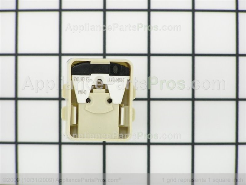

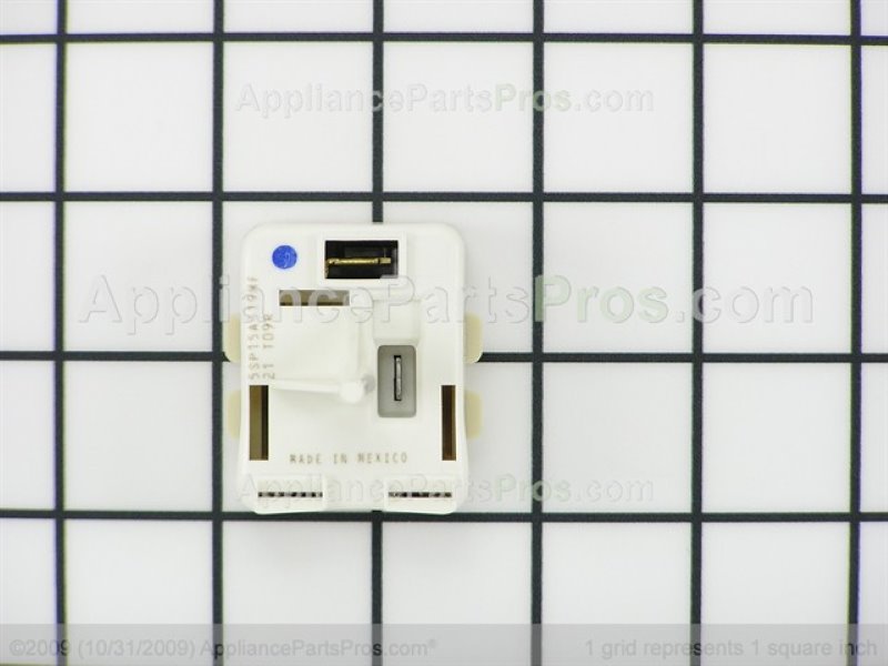

Rick C Dover , DE February 03, 2015 Appliance: Model GE PROFILE MODEL # PSS23MGTCCC Burning actual flame coming out of 5sp overload/ptc We isolated a burning smell in our kitchen to our refrigerator, GE Profile PSS23MGTCCC which we purchased in November of 2006. This occurred at 3AM on 29 January 2015 and I am thankful that my wife got me up to investigate this odor. I unplugged the refrigerator. I plugged the refrigerator back in at 6AM thinking it had time to cool. The burning smell happened immediately and I unplugged the refrigerator again right away. My son in-law looked up some possible issues that could have happened based on other individual experiences from write-ups on the AppliancePartsPros website. I actually ordered a Main Control Board, Run Capacitor, Motor DC Cond Fan and 5SP Overload/ptc knowing that we could return what we didn't use. I'm keeping them all in case something else happens and parts become unavailable to order. My son in-law came over at 5PM after his work day. We pulled the cover off the main board and also the long cover over the rest of the components so that we could hopefully see from where this smell was coming. After plugging in the cord, we immediately saw a 1" Flame shooting downward from the 5SP Overload/ptc. We pulled the plug and the flame stopped. We then pulled the 5SP Overload/ptc along with the run Capacitor (both are attached to each other) from the pins on the Compressor. We checked the pin voltage on the Compressor as well as the Run Capacitor and both of these items appeared fine. I already had ordered a new 5SP Overload/ptc along with another Run Capacitor. I did view videos available on AppliancePartsPros.com which were outstanding and helped understand the installation process which was simple. We received the parts in one day and had our refrigerator back and operational quickly. Even though the original Run Capacitor was fine, I decided to replace it as well since it was attached to the burned 5SP Overload/ptc. In addition, yesterday, Monday, 2 February, I decided to call GE Support and ask about any recalls that might be pertinent to our refrigerator. I was told that there weren't any and that because we didn't have a GE Certified Engineer / Field Technician isolate the problem and suggest repairs, that GE would not be able to offset any parts costs we incurred. We fixed the issue less expensively than having a GE Certified Technician come to our home but we weren't able to get GE assistance because of our decision to repair it ourselves. This is something we all should consider the next time there is a problem. This doesn't mean that GE would cover the cost of the service charge, parts and labor if they were there for the repair. They would make that decision based on the Technician's findings. Read More... 16 People found this story helpful Do-It-Yourself Rating: Repair Time Estimate: 30-60 minutes Tools: Nut Drivers, Pliers
George S Columbus , OH June 28, 2015 It would cooling then shut off atfer we unplug it & plge it back in it would work for three or foud days Replace main bard run capacitor & overload Read More... 11 People found this story helpful Do-It-Yourself Rating: Repair Time Estimate: 30-60 minutes Tools: Nut Drivers, Screwdrivers

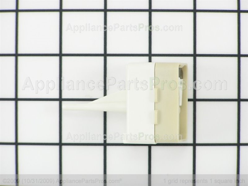

Scott C Wilsey , KS February 24, 2017 Appliance: Model 2005 GE PROFILE REFRIGERATOR Compressor starter burned out How did I fix it? I lucked out and found your website, that's how. The burned out part has two electrical spades next to each other. I looked at several parts vendor's sites and the images they had of the replacement part only showed one spade. Calls and e-mails garnered a 'Duuuh'. Your site has additional images, one of which shows the second spade connector. To make things even better, you have a video explaining which wire to which spade. Holy Crappoly!! How lucky can a guy get? Whoever thought up your business model deserves a beer. Read More... 3 People found this story helpful Do-It-Yourself Rating: Repair Time Estimate: Less than 15 minutes Tools: Nut Drivers, Pliers
