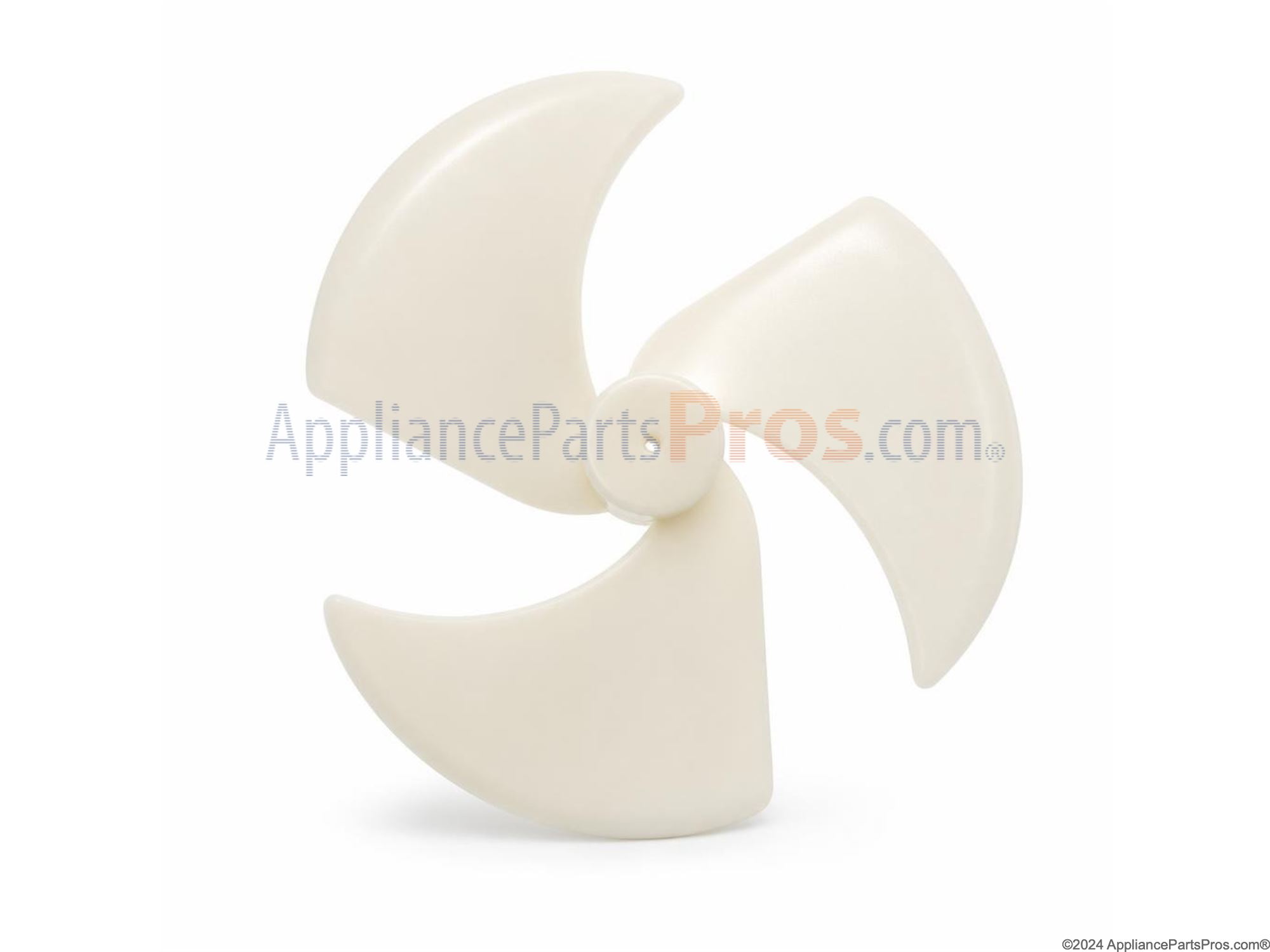

John W Spring City , PA May 17, 2023 Appliance: General Electric Refrigerator GTE21GTHCWW Loud/broken condenser fan on GE refrigerator. The back of our GE refrigerator got really loud out of nowhere. Thinking something was stuck in the fan, I pulled it away from the wall, and removed the back access cover. It was filthy so I unplugged the fridge and used a soft attachment to vacuum the coils carefully, as to not damage them. Nothing was stuck in the fan, but one of the blades was broken, so I determined the noise was from one fan blade hitting the casing on every rotation. We didn’t the fridge to die so I kept an eye on it until I could get parts. I googled condenser fan and found a few videos that showed many fans can simply be pulled off the motor. So I input my refrigerator model number, and ordered the part. It arrived way faster than I expected! In the meantime, 2 of the fan blades had broken off the 3-blade fan, so I was really also hoping the condenser fan motor and/or compressor wasn’t damaged in the process. The repair was simple… removed 2 screws for the fan/motor casing, and unclipped the electrical plug from the fridge. Carefully pulled fan off the motor and pushed the new fan on. I re-fastened the electrical clip, added the screws for the fan housing, and put the back panel on the fridge with screws, and plugged it in, and it was as if nothing ever happened! We were relieved that the motor and compressor didn't seem to be adversely affected with less airflow from a 1-bladed fan (usually a 3-bladed fan). Glad it was a quick, inexpensive repair too - roughly $25 and a lot of that was shipping. If that repair didn't fix it, I would have then bought the fan motor to replace that, which would’ve cost closer to $200 based on a quick parts search. Read More... Do-It-Yourself Rating: Repair Time Estimate: 15-30 minutes Tools: Screwdrivers
William B Franklin , OH August 17, 2019 Fan blade Put a new one on Read More... 1 People found this story helpful Do-It-Yourself Rating: Repair Time Estimate: 15-30 minutes Tools: Screwdrivers
Nguyen L Hillsboro , OR March 19, 2018 Appliance: Model GE REFRIGERATOR MODEL # GIE21GSHBSS The condenser fan blade off the GE refrigerator in the guest room was broken and made it so loud. We removed the broken blade, then ordered the part from AppliancePartsPros to replace it. Read More... Do-It-Yourself Rating: Repair Time Estimate: Less than 15 minutes Tools: Pliers, Screwdrivers
Tammy B Ladysmith , WI February 12, 2023 The freezer getting to warm and the unit is running to long. Replaced the plastic fan blade with another new fan blade. Wish they were a little more sturdy than plastic. But I hope it will last longer than the one I had in it. Read More... Do-It-Yourself Rating: Repair Time Estimate: Less than 15 minutes Tools: Screwdrivers
Theodore R Beach Haven , NJ October 06, 2020 Appliance: General Electric Refrigerator GTE21GSHBSS Condenser fan making flapping noises. Turned off refrigerator,disassembled rear panel, unplugged fan, removed fan, checked fan blades, found crack in one blade, ordered new fan blade. Removed old blade from motor with plyers, installed new blade, tested it and then re-assembled/secured fan, cleaned dust out of lower frig area, coils, condenser, re-assembled cover, plugged in, fixed.... Read More... Do-It-Yourself Rating: Repair Time Estimate: 15-30 minutes Tools: Pliers, Screwdrivers
