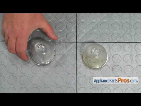

Garett N Lubbock , TX May 06, 2016 Appliance: Model JMS07001HA Oven would not heat and oven light wouldn't work Tested the power to the unit by turning on the cooktop portion and saw that I had power to all of the burners. Turned the selector knob to broil and saw that the top element would heat up. I then turned off the breaker to the unit. I then decided to take out the baking element to do a continuity test. When I touched it, a 1.5 inch section fell out. Since that concluded my continuity test, I assumed I needed a baking element. After receiving the parts the NEXT DAY (amazingly great service from Appliance Parts Pros), I replaced the element after watching the helpful video. After turning the breaker back on, tested the element and it began heating as it is supposed to. As I stated above, the light also didn't work, so I had ordered a lamp cover and retainer when I ordered the element. It took a minute or so to change those out, replacing the bulb in the process solved the light issue. My sister-in-law called me a couple of hours later and said that she was enjoying watching her oven cook a great supper and I am her Hero! The only thing I would add is that our unit is a 40 year old GE Mark 27 unit. The video used a standard oven range that was much newer. The repairman in the video simply unplugged the wires from the baking element. In my unit there was a screw that attached the wire to each blade on the element. It was a pain in the neck simply because of the position you have to stay in to have both arms at the back of the oven performing this feat. If you have this same situation, my recommendation is to do a test run putting the new screws into the holes in the blades BEFORE you try it inside the oven. This cleans out the threads and makes it much easier to attach it inside the oven with very short wires and not much room to work. Hope this helped! Read More... 65 People found this story helpful Do-It-Yourself Rating: Repair Time Estimate: Less than 15 minutes Tools: Nut Drivers, Screwdrivers

Roland L Manchester , NH March 31, 2014 Broken bulb cover in oven Replace cover with new order I order Read More... 3 People found this story helpful Do-It-Yourself Rating: Repair Time Estimate: Less than 15 minutes Tools: Pliers
Estella M Fort Worth , TX February 16, 2016 Broken light cup Replaced with the new one ordered from in 5 seconds Read More... 3 People found this story helpful Do-It-Yourself Rating: Repair Time Estimate: Less than 15 minutes
