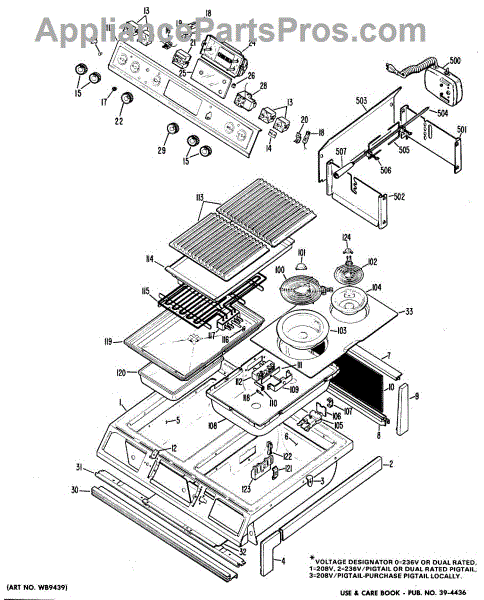

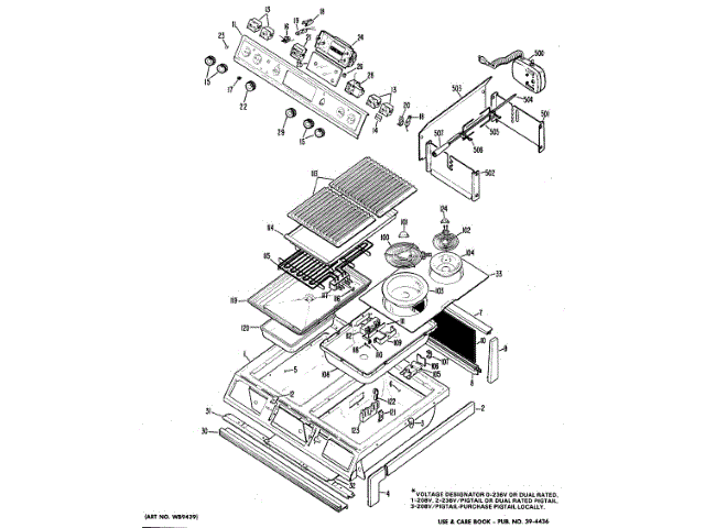

Roger H Altadena , CA January 23, 2016 Appliance: Model GE JHP66G002 My 1984 ge elwctric stove had two burners that were either turned off or no matter what the non off switch position on high My 1984 GE Electric Stove model number was very close to an another entry, but not actually in appliance repair pros' model numbers list. But my burners looked and measured the same for the near entry number, and the surface unit control switch looked very similar. I decided to take a chance and ordered 2 of each.. (Actually I wouldn't have needed new burners but an earlier "repair guy" took 2 of my burners and never returned - and no one could find him!) It turned out the new burners fit perfectly, but although the surface unit switch connected up electrically identically to my old one, it wouldn't seat properly in the built-in board receptical where the old one had. I wound up lashing both new surfface unit switches down inside the old recepticals with "bailing wire" (actually soft metal paperclip wire). That was awkward and tedius to install using, needle nose plyers between other components. But worse, I then noticed that somehow in the process earlier of removing the old switches, I had knocked off one of the circular printed heat level indicaters that turn with the switch control rod and show through the glass stove front. It had fallen down between the glass and main circuit panel. I then had to take apart quite a bit of the glass front assembly in order to retrieve the dropped circular heat level indicator. Altogether I spent about 1 day on this fix. Probably it would have been more like 1/2 day if I hadn't dropped the heat level indicator into a tough place to retrieve it. Also if the surface unit switch had just snapped into place, maybe only a couple hours. But it was an interesting experience over all, and the stove's working fine now. Read More... 16 People found this story helpful Do-It-Yourself Rating: Repair Time Estimate: Less than 15 minutes Tools: Pliers, Screwdrivers, Wrench Set
