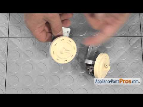

Karen S Parker , CO August 26, 2016 The water inlet valve and the pressure switch The video that you have on your web site is wonderful, after watching it I was able to fix all three parts and it went as easy as your video showed. I will use your site for any future appliance problems. I wish your worked with furnace's. Thanks again for all the info. Read More... Do-It-Yourself Rating: Repair Time Estimate: 15-30 minutes Tools: Pliers, Screwdrivers
