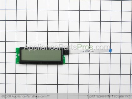

Dave October 10, 2014 for Model Number bosch SHE66C05UC/46 The display panel no longer lights up. The part shows as a control board but it is actually the display that is not working. Are they the same thing.
1 Answer Dave, The display module for your unit is part number 00424675 and is a led control board. Read More...

Les P May 29, 2014 for Model Number Bosch WFR2460 UC/01 FD8201 Display Module ( AP3854652 ) light went out. Replace the whole module required?
1 Answer Hello Les. Yes, if there is power to the display board and no display, you will need to replace it. Read More...
