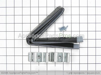

Regina November 06, 2021 for Model Number Washer GHW9400PW4 DRYER GEW9250PW1 NEED TO KNOW WHAT STACKING KIT TO BUY Hi Hun, I need to stack my washer and dryer. The model # for washer GHW9400PW4 AND the Dryer's # is GEW9250PW1. I need to know what stacking kit to buy. Thank you
1 Answer Regina, Thanks for the question!!! Your owner's manual (both models) calls for the part number 8541503. Read More...
Charles August 28, 2021 for Model Number WFW5620HW I have an older Duet dryer (WED95HEDW0). Can this be stacked onto a new washer (WFW5620HW). I noticed that the depth of the new washer is less than the previous one by an inch or so.
1 Answer Charles, the stack kit W10869845 should allow the dryer to stack onto the washer. If measuring the top of the dryer and the washer, the dryer should have an overhanging lip that is about an inch out from the back panel of the dryer. Read More...

Meg March 19, 2021 for Model Number WED9750WW0 I was told the correct stacking kit to stack my dryer onto WFW9750WW01 is 8541503 however it appears to have about an inch bend in the metal which would make the dryer sit back about 1 inch from the front of the washer. Is that correct or is there a different stacking kit that should be used?
1 Answer Meg,Based on the model number provided the stacking kit per the manufacturer is mfg#8541503 our part number is 8541503 Read More...
