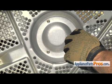

Cause #2 Dryer Rear Drum Bearing Kit
14%of the time
Total Satisfaction Rating (880)
Cause #3 Dryer Drum Bearing
7%of the time
Total Satisfaction Rating (80)

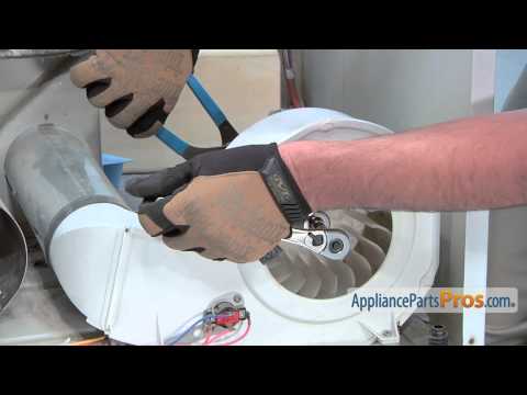

Cause #6 Motor
2%of the time
Total Satisfaction Rating (68)

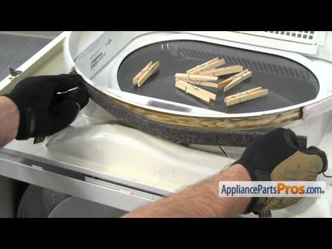

Cause #7 Dryer Lower Drum Felt Seal
Less than 1%of the time
Total Satisfaction Rating (118)

Cause #11 Dryer Upper Felt Seal
Total Satisfaction Rating (45)
