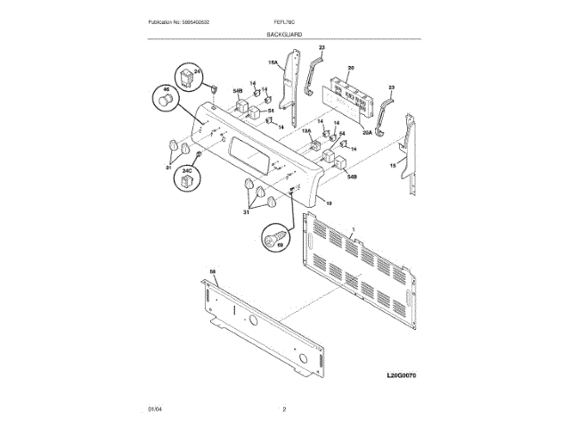

Cause #6 Electric Range Broil Element
Less than 1%of the time
Total Satisfaction Rating (20)
