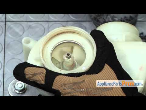

Cause #5 Pump Seal And Impeller Kit
2%of the time
Total Satisfaction Rating (48)

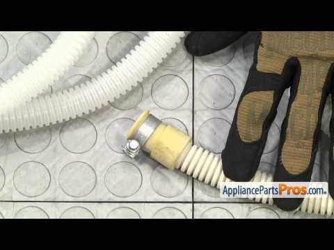

Cause #8 Dishwasher Drain Hose
Less than 1%of the time
Total Satisfaction Rating (12)
