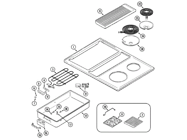

Magic Chef Range 6892XVS Element will not heat
Element will not heat is the most common symptom for Magic Chef 6892XVS. It takes Less than 15 minutes to fix on average. The instructions below from DIYers like you make the repair simple and easy. Many parts also have a video showing step-by-step how to fix the "Element will not heat" problem for Magic Chef 6892XVS. So, if your 6892XVS range element gives no heat, element is cold or element not heating, the following info will help you identify the problem.
Parts for Magic Chef 6892XVS
Cause #1 Range Surface Element Receptacle Kit
45%of the time
Total Satisfaction Rating (68)
Cause #2 Cooktop 6 Inch Surface Element
18%of the time
Total Satisfaction Rating (131)
Cause #3 Range Infinite Switch Top Burner Control
9%of the time
Total Satisfaction Rating (96)
Cause #4 Electric Range Bake Element
7%of the time
Total Satisfaction Rating (192)
Cause #5 Electric Range 8-Inch Surface Element Kit
5%of the time
Total Satisfaction Rating (8)
Cause #6 Range Infinite Switch Top Burner Control
4%of the time
Total Satisfaction Rating (13)
Cause #7 Cooktop 8-Inch Surface Element
3%of the time
Total Satisfaction Rating (12)
Cause #8 Range 6-Inch Surface Element
3%of the time
Total Satisfaction Rating (10)
Cause #9 Range Drip Pan Or Bowl
Less than 1%of the time
Total Satisfaction Rating (264)
Cause #10 Range Drip Pan
Total Satisfaction Rating (188)
Cause #11 Oven Temperature Sensor
Total Satisfaction Rating (157)
Cause #12 Terminal Block
Total Satisfaction Rating (36)
Cause #13 Oven Broil Element
Total Satisfaction Rating (1)
