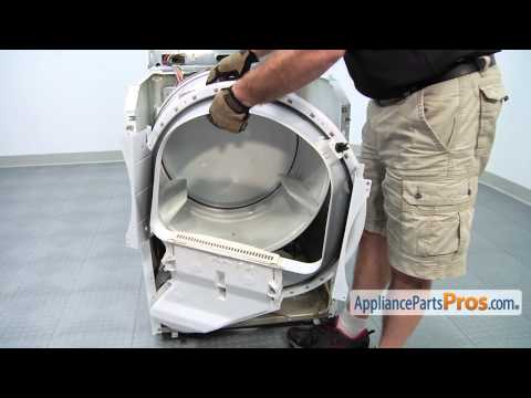

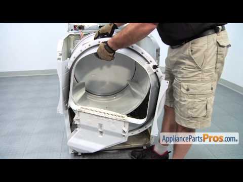

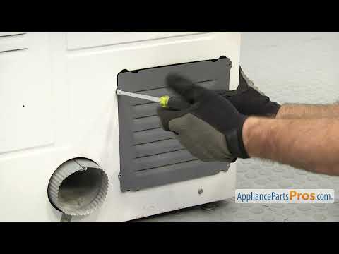

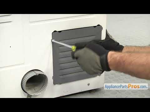

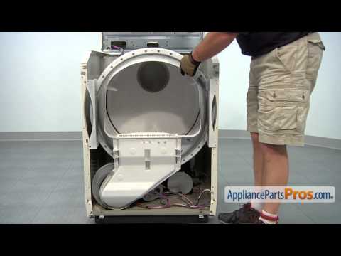

Will not tumble is the 4th most common symptom for Maytag LDG8600AAW. It takes 30-60 minutes to fix on average. The instructions below from DIYers like you make the repair simple and easy. Many parts also have a video showing step-by-step how to fix the "Will not tumble" problem for Maytag LDG8600AAW. So, if your LDG8600AAW dryer drum doesn't tumble, not turning or won't spin, the following info will help you identify the problem.
