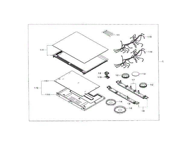

Thomas R Jacksonville , FL September 22, 2018 Appliance: Samsung Electric Range NE58F9500SS/AA-0000 I burned a hole in the coating(?) of the glass cook top functional but not pretty APP had the exact part I needed, and it arrived in only 2 days. I have nothing but praise for APP, but I wish there were detailed installation instructions. Removing the cooktop was easy - reinstalling was less so. For someone who wants to take on the challenge, I'll describe the process, including some of the problems I had. 1. Order from APP. That's the easy part! 2. Cut the breaker for the stove. Or you can slide it out and unplug. You'll probably end up sliding it all the way out anyway. 3. Remove 3 screws holding on the strip at the back. Remove two screws on each side at the top of the back of the stove. 4. It's probably a good idea to pull off the handles, but I'm not sure it's necessary. 5. Open the oven door and remove the 4 screws underneath the control panel. Rotate the panel up and carefully slide it off the clips at the top. 6. (You may want someone to hold the control assembly while you do this) Unplug the 3 big plugs. Unplug two smaller ones plugged directly into the panel, on the right side. Set the control panel aside. - the big plugs were not that easy to undo 7. Unscrew two screws on each side of the front. Unscrew 2 screws on the silvery piece directly below the cooktop. (I THINK that latter is required). 8. Lift the cooktop and burner assembly from the stove. There are 3 clips on the back which will require lifting the front up first, until the angle is sufficient to lift the back off the clips. 9. Lay the old assembly on the floor with the glass top on the bottom. 10. Remove 8 screws, 4 on each side, holding the burner assembly to the glass top. 11. The heat light indicator assembly (located center front of an assembled stove) is held on by metal projections bent to the side. Bend those straight and get them off the glasstop frame. 12. Remove the burner assembly and set it aside. You're ready to install the new glass top. Reassembly is the reverse of disassembly. If only it were that easy. - I was very careful to remove every tiny bit of styrofoam that was on the new glasstop. I was concerned that those bits would immediately catch fire as soon as I turned on a burner. - Getting the heat warning lights piece in place was of moderate difficulty, as you need to hold the burner assembly up while you work it in. - Getting the glasstop+burner assembly on the rear clips required that I slide the stove completely out of its recess. This was because the countertop kept the edges of the glasstop from dropping down far enough. It might have just been my incompetence, but sliding out the entire stove was the only way I could do it. - Sliding the stove back in was a delicate process in my case, because the back of the countertop was lower than the front, so I had to use shims and blocks to ensure there wasn't too much pressure on the glasstop. - Alignment of the front screws in the glasstop frame, and the screws underneath the control panel, was a nuisance. Read More... Do-It-Yourself Rating: Repair Time Estimate: 1-2 hours Tools: Screwdrivers
Dennis J Rockford , IL June 28, 2016 Appliance: Samsung Electric Range NE58F9500SS/AA-0000 Broken glass cooktop on samsung slide in range Had an estimate from an appliance repairman for $650 that included a new cooktop for $350 and two hours of labor. I bought the cooktop from appliance parts pro for just over $200. Taking my time, since I had never done this type of repair before, I finished in just under an hour and a half. The only tool required was a Phillips screw driver. Read More... 96 People found this story helpful Do-It-Yourself Rating: Repair Time Estimate: 1-2 hours Tools: Screwdrivers
Brian C Salt Lake City , UT January 05, 2016 Glasstop was shattered Purchased this part. Unscrewed back of range, opened oven door, unscrewed control console. Pulled off control knobs and unscrewed them from console (not sure I had to do that). Pulled console off by pulling up and out (this was the most difficult part, there are two tabs connecting it to glass top part. Unplugged electrical and finished unscrewing glasstop part. I then removed the broken glass and unscrewed the burner assembly from the glasstop assembly. I then screwed the burner assembly to the new glasstop piece and put everything back together. Took me a little over an hour to figure everything out. Read More... 27 People found this story helpful Do-It-Yourself Rating: Repair Time Estimate: 1-2 hours Tools: Screwdrivers
Maureen B Summerville , SC October 08, 2015 I dropped an item of side of glass top slide in oven which cracked top Ordered part, researched on Ytube for repair video - all went great - part was perfect - looks just like new. thank you for making it easy and cost effective. Read More... 14 People found this story helpful Do-It-Yourself Rating: Repair Time Estimate: 30-60 minutes Tools: Screwdrivers
Brandon F Iron City , GA December 05, 2016 Cracked glass top Got replacement top from appliancepartspros.com. Took me a few minutes to figure out how to replace it but it was not hard, took me about 45 minutes to change. Read More... 7 People found this story helpful Do-It-Yourself Rating: Repair Time Estimate: 30-60 minutes Tools: Screwdrivers
