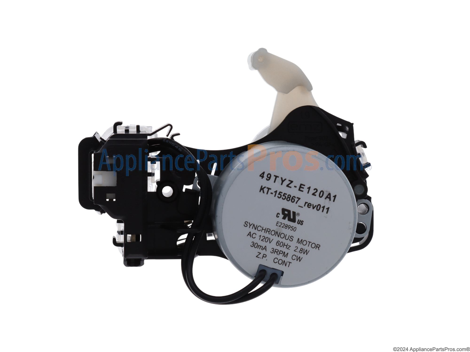

Joseph T D Inverness , FL October 13, 2025 Shift actuator broke on 14 month old whirlpool washer Diagnosed the problem, and tracked down the part I needed at Appliancepartspros.com Read More... 1 People found this story helpful Do-It-Yourself Rating: Repair Time Estimate: Less than 15 minutes Tools: Screwdrivers, Socket Set
Jesse M Nipomo , CA October 04, 2025 Appliance: Whirlpool Laundry, Residential, Washer WTW5100HC2 Shift actuator With the video that was made from appliance pro.Help me out one hundred percent to understand what I was dealing with Read More... 1 People found this story helpful Do-It-Yourself Rating: Repair Time Estimate: 15-30 minutes Tools: Screwdrivers, Socket Set
Allen T Mount Vernon , IL February 08, 2026 Appliance: Maytag Washer MVW6230HC3 F7 e1 Changed the shift accuator and capacitor Read More... Do-It-Yourself Rating: Repair Time Estimate: 30-60 minutes Tools: Nut Drivers, Screwdrivers

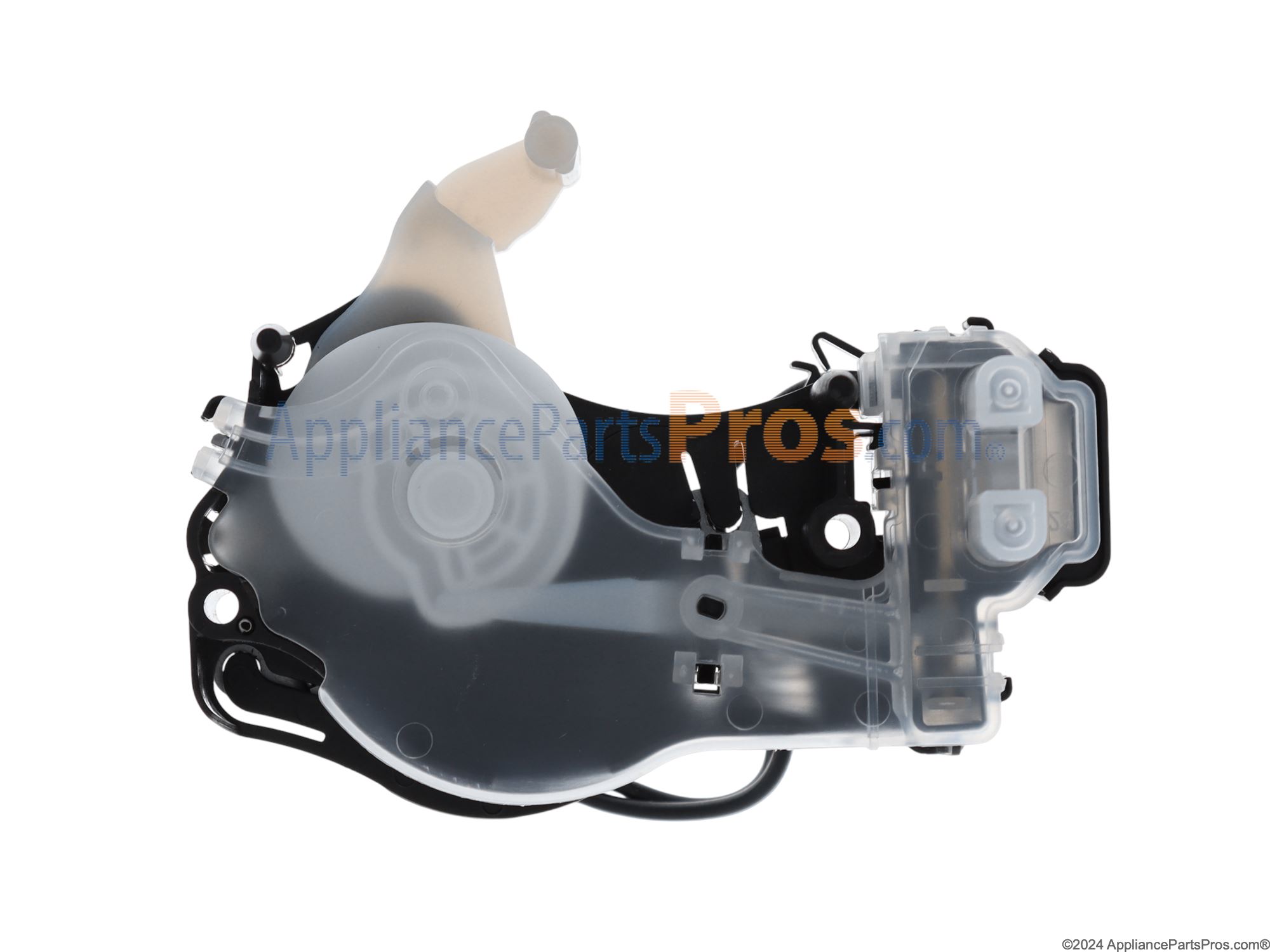

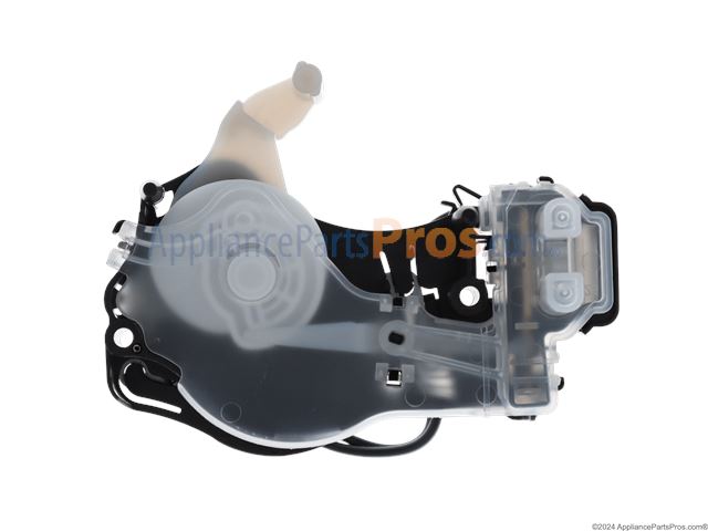

Timothy G Twinsburg , OH September 26, 2026 Appliance: Model WTW4816FW3, TYPE 687-20. Washer would not go to the "wash" cycle after filling tub washer would not drain or spin Whirlpool Top Load Washer, Model WtW4816FW3, Type 687-20. Used Whirlpool Technical Manual (not the diagnostic test card) W11697231, Rev A. Drum Motor, Shifter Motor, Pulley belt and Drum clutch and pulley assembly are all accessed from the bottom, there is really no need to remove entire rear cover. However the rear control panel cover needs to be removed to access Main Control module. Because the washer did not seem to cycle, suspected Shifter motor assembly. Could not access diagnostic function until Shifter Motor (W11481722) replaced, then ran the diagnostics. Be careful when replacing the Shifter Motor actuator arm placement into the "splutch" cam arm slot. It is very important to locate the neutral position of the splutch cam arm. Finding the correct position between the "Agitate" and "Spin" position is tricky. If this is not done the Shifter Motor will not work and will not allow access to the front panel control diagnostic test. Shifter motor position may have to be done a few times to locate the neutral cam position. Read More... Do-It-Yourself Rating: Repair Time Estimate: 1-2 hours Tools: Nut Drivers, Pliers, Screwdrivers, Wrench Set
Arthur S Germantown Hills , IL June 08, 2022 Washer would not go into spin cycle. Replaced transmission shift actuator assembly, and lubed all gears. Read More... Do-It-Yourself Rating: Repair Time Estimate: 15-30 minutes Tools: Screwdrivers, Socket Set
