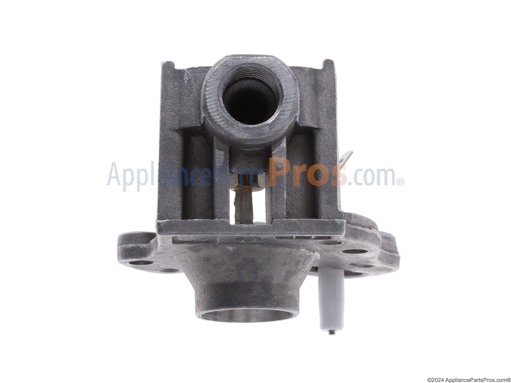

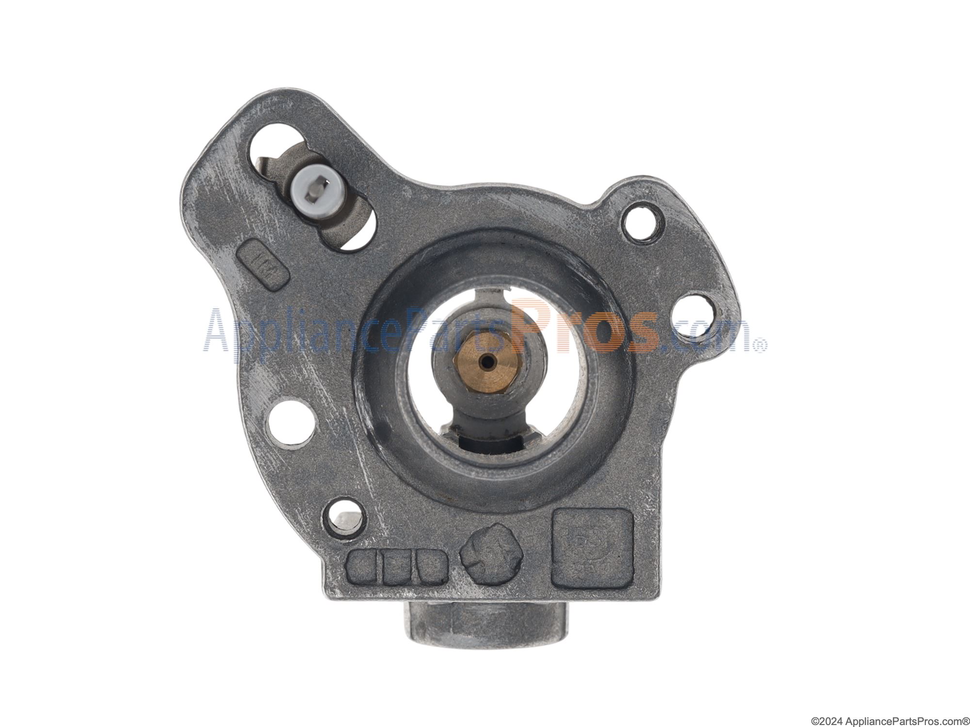

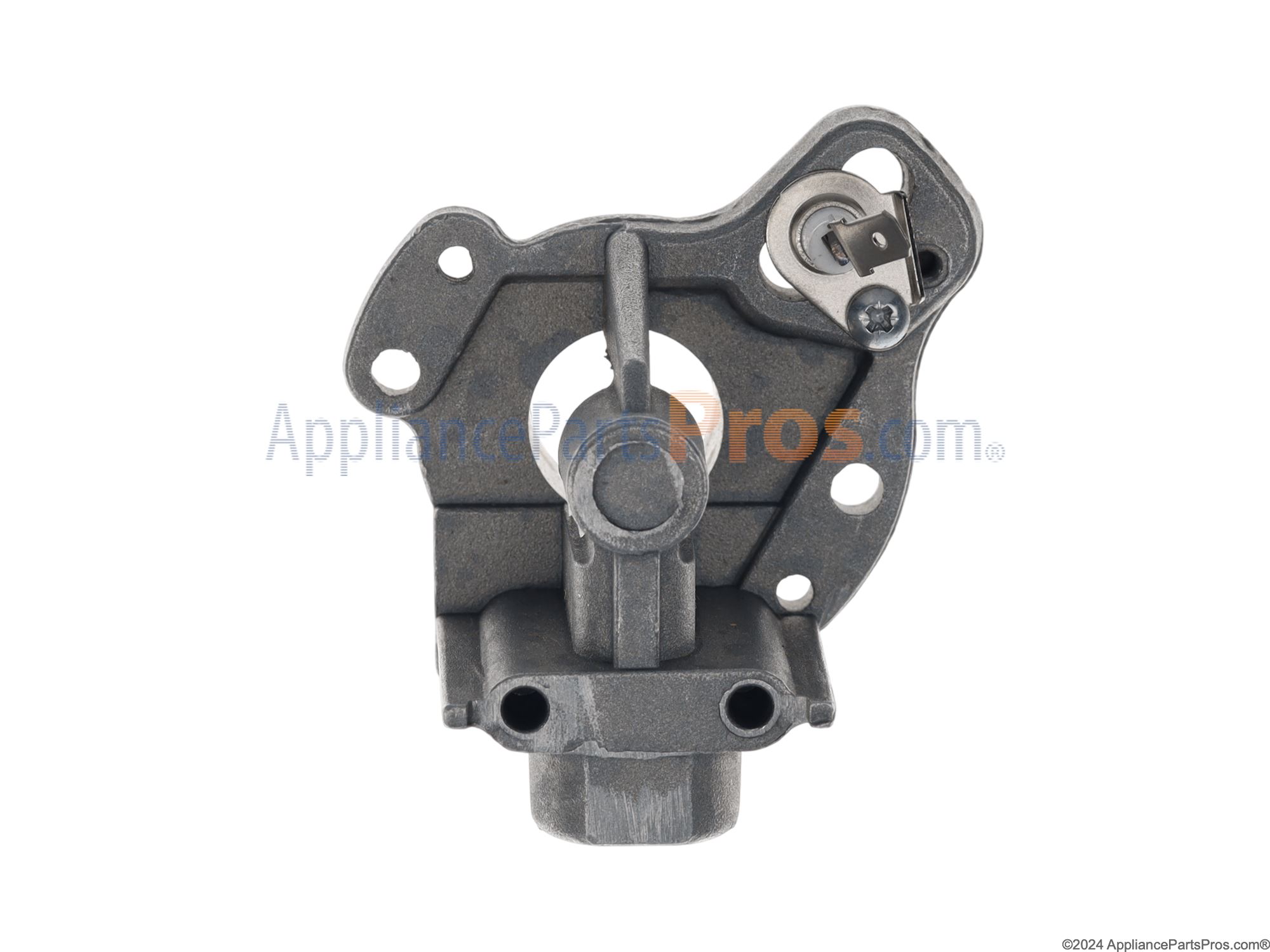

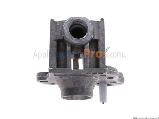

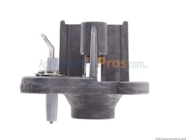

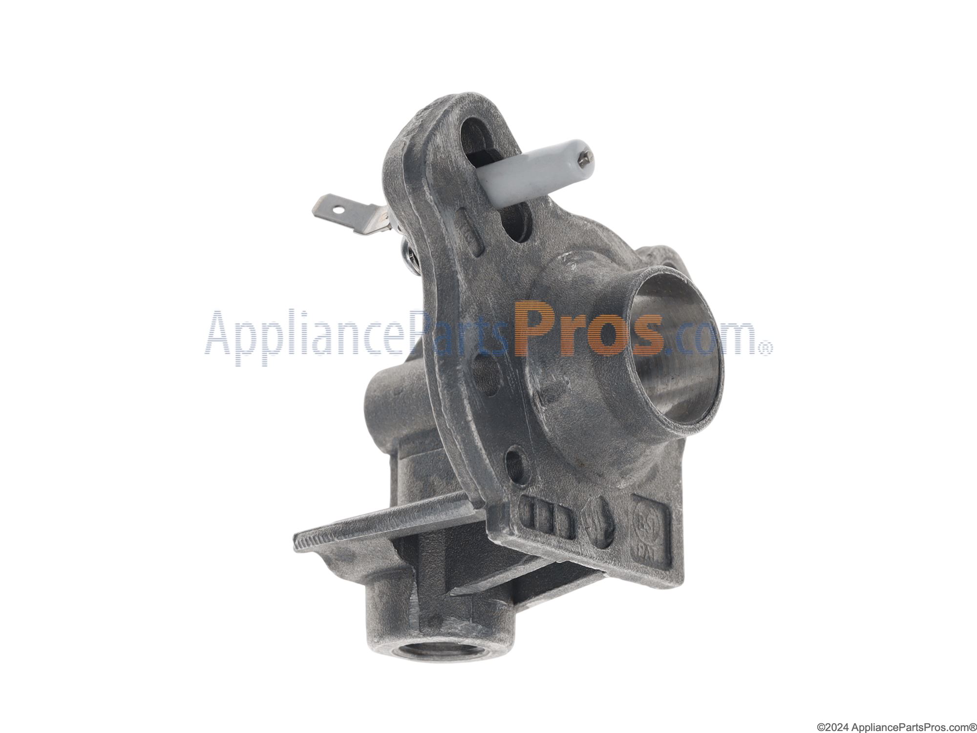

James M Brooklyn , WI November 23, 2015 Appliance: Jenn-Air Freestanding-Double Oven-Dual Fuel JDR8895AAS I needed to convert my jenn air stove top range back to natural gas from lp and the orifices were not available by themselves so i needed to order new orifice holders that included the ng orifices I had to drill out the screws that hold down the burner plates which also mount to the orifice holders because all of the screws had rusted tight and could not be loosened. The drilling out part was fairly easy and once I had removed the burner plates, I could easily lift the stove top off and get access to the orifice holders to replace all of them. I purchased new stainless steel self-threading screws from our local hardware store and re-assembled the new orifice holders and existing burner plates. I was very careful in drilling out the screws and did not damage any of the burner plates. Lastly, I had to access the gas regulator in the back of the oven to remove the plug and flip over the plug to switch the regulator to NG. The burners all work very well and I saved myself $250-300 in labor quoted by a contractor. The contractor was also going to charge me about $60 more for the orifice holders than I paid for the parts from Appliance Parts.com Read More... 7 People found this story helpful Do-It-Yourself Rating: Repair Time Estimate: 1-2 hours Tools: Adjustable Wrench, Pliers, Screwdrivers, Wrench Set
Seamus O Westwood , MA January 27, 2015 Had to convert my stove and dryer from propane to natural gas Ordered the parts from appliance parts pros and installed parts I did have to drill out the existing screws holding the existing orfice holders as the existing screws were rusted out Read More... 3 People found this story helpful Do-It-Yourself Rating: Repair Time Estimate: 1-2 hours Tools: Nut Drivers, Screwdrivers, Socket Set
Thomas D Galloway , NJ April 25, 2020 Appliance: Jenn-Air Freestanding-Double Oven-Dual Fuel JDR8895AAS One burner would not light or adjust when lit manually. Replaced holder /orifice. The only problem with this fix was all of the screws holding the burners in place were rusted and had to be drilled to access the part to replace. So I had to replace all 5 of the Holder/orifice. Relatively easy fix. Read More... Do-It-Yourself Rating: Repair Time Estimate: 1-2 hours Tools: Screwdrivers, Wrench Set
John A Dracut , MA July 18, 2021 Appliance: Jenn-Air Freestanding-Double Oven-Dual Fuel JDR8895AAS My stove was set up for propane and I needed to switch back to natural gas. I purchased the new orifice holders that are complete with the orifices and igniters from AppliancePartsPros.com. They were easy to swap out. Read More... Do-It-Yourself Rating: Repair Time Estimate: 15-30 minutes Tools: Adjustable Wrench, Screwdrivers
