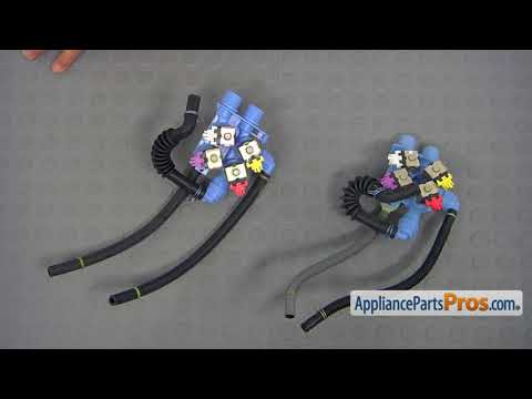

Craig P Olathe , KS January 16, 2017 Appliance: Maytag Washer MHW7000AW0 Very slow water fill was causing error code f8 e1 Replaced water inlet valve assembly Read More... 3 People found this story helpful Do-It-Yourself Rating: Repair Time Estimate: 15-30 minutes Tools: Nut Drivers, Pliers
Rebecca F St Francis , KY November 10, 2020 Had been in storage for years. When we tried to use it again water ran out of the bottom of machine. Replaced inlet valve for $78 and $1000 machine works beautifully again! Read More... 2 People found this story helpful Do-It-Yourself Rating: Repair Time Estimate: Less than 15 minutes Tools: Pliers, Screwdrivers, Socket Set
Thomas R Nescopeck , PA January 02, 2023 My water supply valve froze and broke. Ordered the replacement part from AppliancePartsPros.com and replaced it. Read More... 2 People found this story helpful Do-It-Yourself Rating: Repair Time Estimate: 30-60 minutes Tools: Nut Drivers, Pliers, Screwdrivers
Hannelore B Fennville , MI April 29, 2018 Appliance: Model MAYTAG. Water was leaking onto floor I took off the back of the washer to see where water was coming from. It took until the rinse for the leak to appear. It was a broken seal on the blue part where the hoses are attached. I ordered a new part. I removed the old part when I received the NEW part so I would reconnect the connections in the correct position. I then ran the washer to make sure everything was tight and not leaking. Then put the back and the top back on the washer. Very easy! Read More... Do-It-Yourself Rating: Repair Time Estimate: 30-60 minutes Tools: Adjustable Wrench, Nut Drivers, Screwdrivers
Jim C Cheyenne , WY September 14, 2015 Appliance: Model WFW94HEAWO The water inlet valve froze and broke while in storage Tested the appliance with water hose outside determined the problem removed the part contacted appliance parts pros entered the model number found part needed called contact center ordered part three days later part arrived installed and returned appliance to the young lady who had it in storage , it is now in her new home and back in service one happy friend thank you for the professional and fast service. Read More... Do-It-Yourself Rating: Repair Time Estimate: 15-30 minutes Tools: Nut Drivers, Pliers, Screwdrivers, Socket Set
