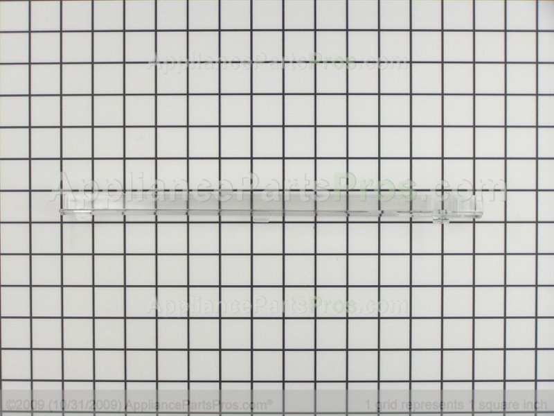

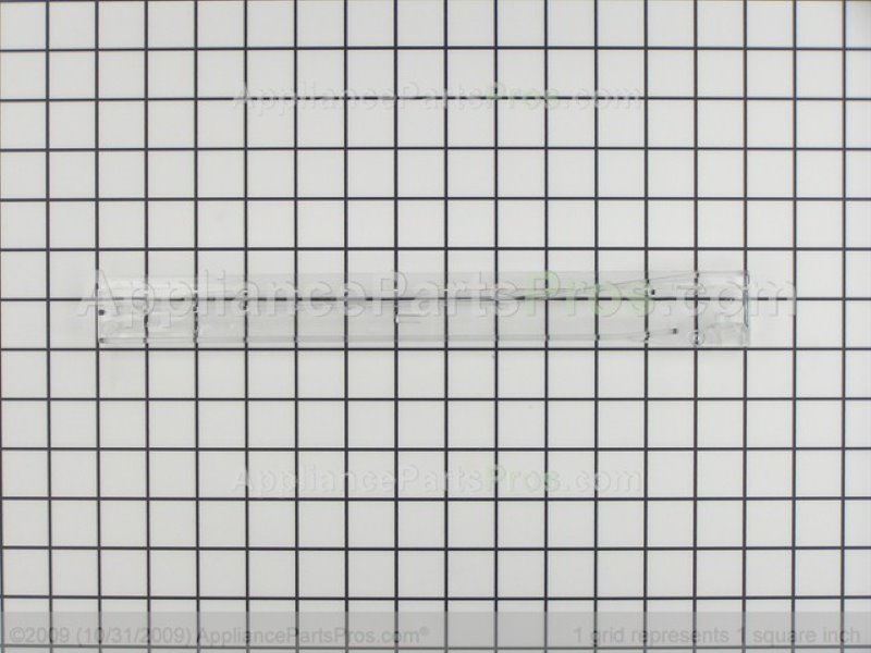

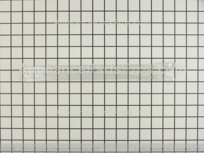

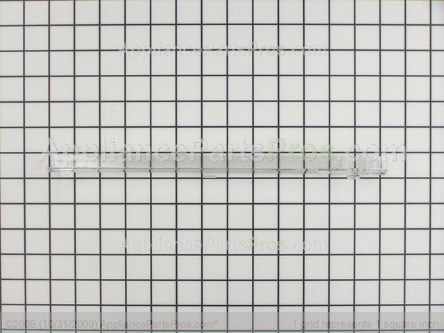

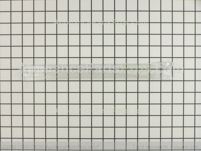

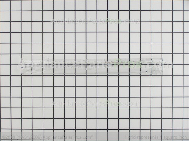

John M New Haven , VT November 24, 2017 Appliance: Model MAYTAG MTB2156GE Rollers broke off the drawer glides in my refrigerator so drawer would fall out when extended Popping the old draw glides off was the toughest part of the job, ad even that was fairly easy, once I noticed the little retaining tabs near the front of the drawer. Pushed in on the tabs, while pushing back on the drawer glide rail and it popped right off. One minor problem I did note: When the rollers were installed on the shoulder screws, they would not turn. One roller just had a burr around the inside edge of the hole. The other the entire bore was a bit undersized, creating a snug fit. I used a 15/64" drill bit to open up the holes a bit - didn't even put the bit n a drill, just twisted it through by hand and ran it back and forth a few times. This allowed the rollers to spin freely on the shaft. (I supposes a round file might accomplish the same thing, if you had one small enough - like one used to sharpen a chainsaw.) One tip: the Phillips head screws look as though they would take a #1 Phillips screw driver, but this would not grab the screws for me. A #2 Phillips worked well, if the bit was in very good condition (not chewed up). Entire process took about 30 minutes total to do the drawer glides on both sides. It would have taken only 15 if I had not had to find my drill bits and ream out the holes in the rollers. Read More... 3 People found this story helpful Do-It-Yourself Rating: Repair Time Estimate: 15-30 minutes Tools: Screwdrivers
Randy H Sharpsville , IN May 22, 2015 Refridgerator was not staying cold freezer portion was missing washers on doors and seal on refridgerator door was split also meat drawer kept falling out I ordered new washers for the doors, a new door seal, and a drawer rail. The folks at AppliancePartsPros were extremely helpful in making sure I got the proper parts and the repair and installation went very smoothly! A refridgerator that I was ready to replace is now working like new. Shipping was fantastic, parts arrived in two days! Read More... 2 People found this story helpful Do-It-Yourself Rating: Repair Time Estimate: 1-2 hours Tools: Nut Drivers, Socket Set
Dan H Wisconsin Dells , WI August 14, 2014 Broken rail Remove the unit from the frig and removed broken rail. The new on fit perfectly. Read More... 2 People found this story helpful Do-It-Yourself Rating: Repair Time Estimate: 15-30 minutes
Conrad R Moore , OK March 08, 2016 Appliance: Model MAYTAG REFRIGERATOR Broken drawer slide rails Replaced the broken parts Read More... 2 People found this story helpful Do-It-Yourself Rating: Repair Time Estimate: 15-30 minutes Tools: Screwdrivers
Vito D Peabody , MA October 03, 2015 The rail cracked and needed to be replaced Very simple fix. A screwdriver was all that was needed to replace the wheel. Slid the new one in and fits perfectly. Read More... Do-It-Yourself Rating: Repair Time Estimate: Less than 15 minutes Tools: Screwdrivers
