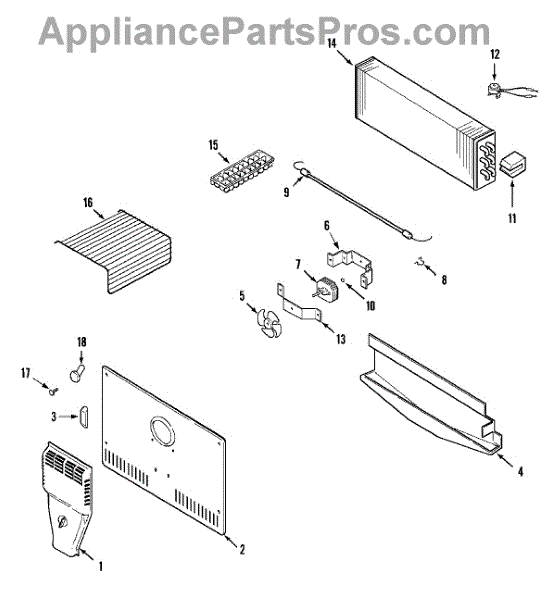

This evaporator fan motor circulates cold air across the evaporator coils and through the freezer and fresh-food sections to maintain even temperatures. Replacing a failed or noisy motor restores proper airflow and dependable cooling performance.
  • Drives the evaporator fan blade to move air over the coils and throughout the cabinet
  • Helps maintain consistent temperatures between freezer and refrigerator compartments
  • Failure symptoms include weak/no airflow, the fan not running, loud squealing/rumbling, or the fresh-food section warming up
  • Poor airflow can also lead to frost or ice buildup on the freezer back panel
What's included: 1 evaporator fan motor Install notes:
  • Disconnect power before servicing; wear cut-resistant gloves and eye protection
  • Access the motor behind the freezer's rear panel; use caution around sharp metal and evaporator fins
  • Note wire positions; transfer the fan blade and any brackets/grommets from the original motor; secure wiring connections
  • Ensure the blade spins freely; engage the door switch when testing and strong airflow after reassembly

This radiant-style defrost heater melts frost from the evaporator during automatic defrost cycles. Replacing a failed heater restores airflow and helps maintain consistent temperatures while preventing ice buildup on the freezer back wall.
  • Heats the evaporator coil to clear frost/ice during the defrost cycle
  • Promotes proper airflow for stable cooling performance
  • Common fix for heavy frost on the back freezer panel, warming in the fresh food section, or a noisy evaporator fan contacting ice
  • If the element tests open (no continuity), the unit will not defrost
What's included: 1 radiant defrost heater
  • Disconnect power before servicing; allow built-up ice to melt for safe access
  • Access from the freezer by removing the rear panel; handle the glass-sheathed element carefully
  • Note wire routing and transfer any reusable shields, clips, or insulation from the original part if present
  • After replacement, verify the defrost thermostat/sensor and control initiate a defrost cycle

This defrost thermostat is the temperature limit switch for the evaporator. It lets the defrost heater run when coils are icy and opens as they warm to end the cycle, helping stop frost buildup and restore steady cooling.
  • Monitors evaporator temperature; closed when cold to allow the defrost heater to energize
  • Opens as the coil warms to terminate defrost and protect components from overheating
  • Failure may cause heavy frost on the back wall/evaporator and weak airflow or a warm refrigerator section
  • Can also lead to long run times or cooling that returns only briefly after a manual defrost
Includes: One defrost thermostat Install notes:
  • Unplug the refrigerator or disconnect power before servicing
  • Located behind the freezer's rear panel on the evaporator; remove shelves/ice bin and panel to access
  • Reinstall in the same position/clip for firm contact with the coil or tubing
  • Make secure, insulated wire connections and route wiring away from sharp edges and moving parts
Troubleshooting tip: At room temperature the thermostat should read open (no continuity); when chilled below freezing, it should read closed (continuity).
