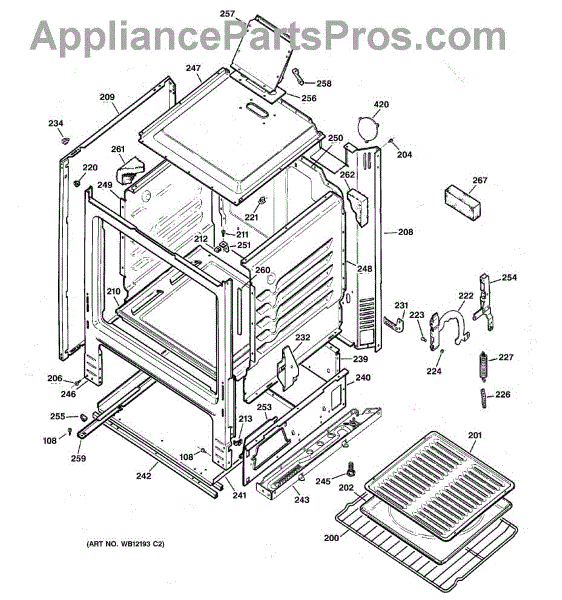

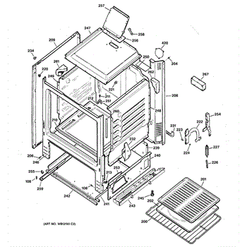

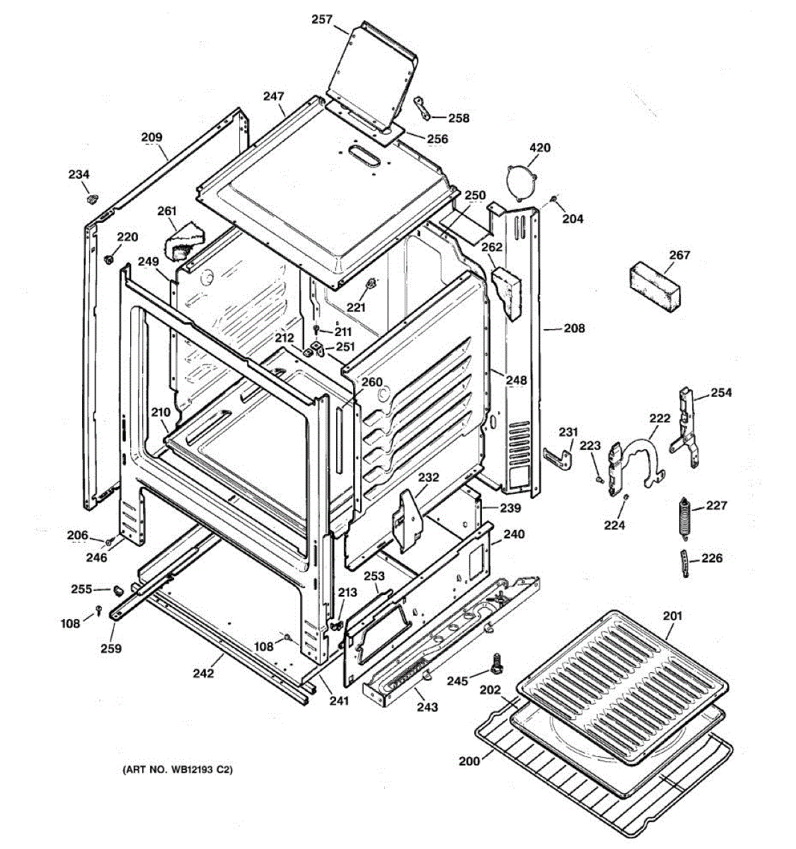

Part Number: WB1X5364
Secures components to your appliance chassis for a rattle-free fit. Replace missing, stripped, or corroded screws to keep panels and brackets aligned.
$10.33
200
5.0 (40)
Part Number: WB48T10095
Replacement oven rack for electric and gas ranges. Installs inside oven cavity. Needed when original rack is missing, damaged, or warped from use.
$68.95
201
5.0 (46)
Part Number: WB48X10056
$34.95
202
5.0 (46)
$34.95
204
Part Number: WZ4X345D
Package of 12
204
Part Number: WB1K5062
206
Part Number: WR01X10065
Size: 10-32 GXTT FLP.595 S
208
Part Number: WB63K20
$31.95
209
Part Number: WB63K50
Color: White.
210
5.0 (28)
Part Number: WB35X37973
Replaces cracked, rusted, or corroded oven bottom pan and heat deflector. Installs in the base of your range oven cavity. Simple 2-screw removal.
$96.55
211
Part Number: WB1K5
Size: 8-18 x 1/2 inch.
212
Part Number: WB1K2
213
Part Number: WB1K3
Speed nut for electric and gas ranges. Secures panels and components inside your range. Replace if stripped, missing, or no longer holding parts firmly.
220
Part Number: WB2K8
$8.70
221
Part Number: WB02K10073
Secures the thermostat sensing bulb to the oven cavity wall for accurate temperature control. Replace if missing or damaged to prevent sagging bulb.
222
Part Number: WB10K12
Replacement oven door hinge assembly for ranges. Installs on the door frame to control opening and closing. Replace if broken, cracked, or no longer springs.
223
Part Number: WB2X6195
224
Part Number: WB2X1082
This retainer secures the oven door hinges in place and is located at the bottom corners of the oven door frame. Replace if the oven door sags, won't stay closed properly, or if the hinges appear loose or misaligned.
226
Part Number: WB2K11
227
Part Number: WB9K1
231
Part Number: WB2K12
Metal safety bracket that secures freestanding ranges to the floor or wall. Replace if bent, broken, or missing to prevent appliance tipping hazards.
$7.66
231
Part Number: WB2K20
Anti-tip bracket kit installs to the floor behind your range or wall oven to prevent tipping. Replace if missing, damaged, or moving to a new home.
232
Part Number: WB34K3
This is the right side hinge guard. For left side use WB34K4.
232
Part Number: WB34K4
This is the left side hinge guard. For right side use WB34K3.
234
Part Number: WB2K66
Right-side guide support secures sliding drawer or shelf rails on your range. Replace if cracked, broken, or worn to restore smooth tracking and alignment.
239
Part Number: WB63K1
$43.95
240
Part Number: WB63K3
Left hand side
$19.76
240
Part Number: WB63K2
Right hand side
$19.95
241
Part Number: WB63K10029
This bottom panel replaces the damaged lower oven floor panel to restore proper support and heat protection for cookware and internal components. It helps stop rattling, sagging, and hot spots that can affect bake performance. What it does:
  • Provides a stable, heat-resistant surface at the bottom of the oven cavity
  • Protects underlying components from spills, drips and direct heat
  • Prevents sagging or warped oven floor that can cause cookware instability
  • Can reduce rattling or vibration caused by a loose or damaged panel
What's included: One replacement bottom panel. Install notes:
  • Disconnect power to the range before beginning any work.
  • Remove oven racks and allow the oven to cool completely.
  • Handle edges carefully; use gloves to avoid cuts and protect the finish.
  • Installation typically requires removing access screws and aligning the panel into the oven floor supports.
$78.27
242
Part Number: WB63K5
243
Part Number: WB63K10232
Support base plate for electric and gas ranges. Mounts underneath to provide structural stability. Replace if cracked, broken, or missing for secure installation.
$27.43
243
Part Number: WB63K10233
Support base for electric and gas ranges. Provides structural support for internal components. Replace if cracked, broken, or missing to restore stability.
$25.48
245
Part Number: WB02X10521
Adjustable leveling leg for electric ranges. Installs on the bottom corner of the unit. Replace if broken, cracked, or missing to level your range.
246
Part Number: WB63K31
Frame weld for gas ranges. This structural component supports the range cabinet. Replace if cracked, broken, or damaged during repair work.
$93.78
247
Part Number: WB53K1
Replace your gas range's damaged or worn oven top panel. This structural cover installs over the oven cavity, restoring your range's appearance.
248
Part Number: WB53K2
Right hand side
$33.70
249
Part Number: WB53K3
Left side panel for gas range ovens. Replaces cracked, damaged, or missing exterior side panels. Structural component for oven cabinet assembly.
$41.53
250
Part Number: WB53K10016
$38.95
251
Part Number: WB2K3
Metal angle support bracket that secures interior panels, shelves, or trim inside your range. Replace if cracked, bent, or missing to maintain proper alignment.
$6.39
253
Part Number: WB2K4
Replace your range's access spring cover if it's cracked, broken, or missing. This protective housing installs over the spring mechanism for a complete look.
254
Part Number: WB10K14
Left hand side
254
Part Number: WB1K53
Mounting screw that secures the hinge assembly on electric and gas ranges. Replace this fastener if the original is stripped, missing, or damaged.
$8.80
254
Part Number: WB10K13
This support rivet securely fastens internal components within your range or oven structure. It provides structural stability for mounting brackets and panels inside the appliance. Replace this rivet if you notice loose parts rattling inside your oven or range components shifting during use.
255
Part Number: WB2K5
Broiler stop bumper for gas ranges. Installs on the broiler drawer to prevent overtravel and cushion closure. Replace if cracked, broken, or missing.
$22.66
256
Part Number: WB32K1
257
Part Number: WB38K4
258
Part Number: WB38K3
$8.12
259
Part Number: WB39K2
Bottom left range slide.
259
Part Number: WB39K1
Bottom right oven rack slide for gas ranges. Guides and supports oven racks for smooth gliding. Replace if cracked, bent, or missing for proper rack operation.
$11.03
260
Part Number: WB32K2
Cushions your range oven door perimeter to prevent metal contact and reduce heat loss. Replace when worn, compressed, or door closes harshly. Confirm fit.
261
Part Number: WB35K1
262
Part Number: WB35K16
Thermal insulation pad that installs behind the oven cavity. Replace if cracked, deteriorated, or missing to restore heat protection for rear components.
$57.39
267
Part Number: WB6K2
420
Part Number: WB34K16
